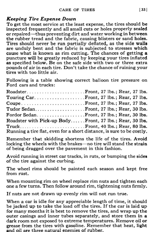

I see a recommendation of 27 PSI all around for balloon tires on a runabout in the 1926 Ford Owner's Manual. Does that sound correct?

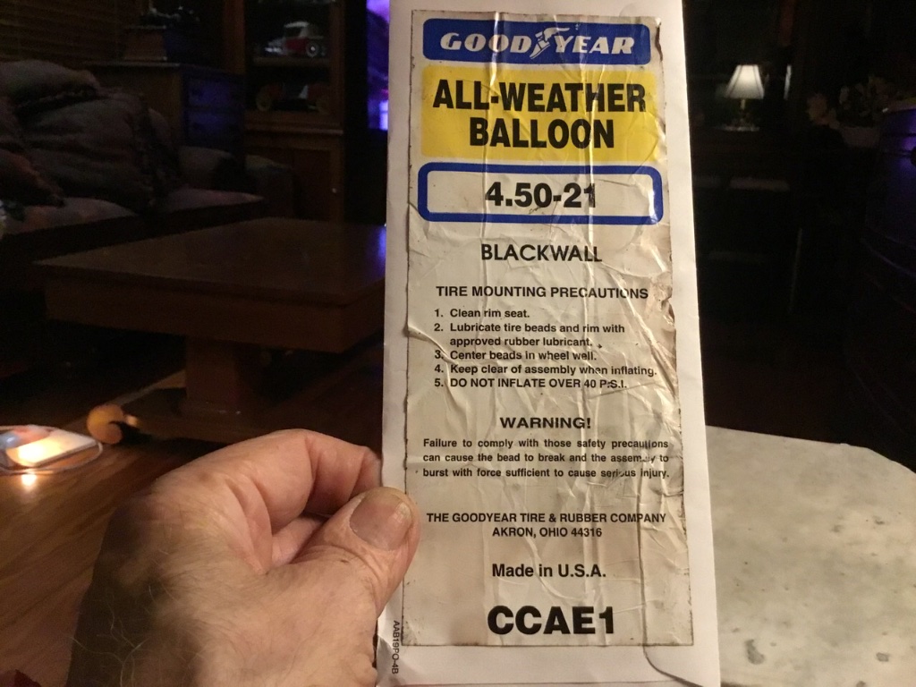

Post by jiminbartow » Sun May 16, 2021 10:08 pm
A century ago, when the Model T manual was published, the majority of roads were dirt with deep ruts and pitted with potholes. Times are different and driving conditions and the quality of modern day tires are much better now, so the tire recommendations of the 1920’s are not necessarily pertinent to 2021 with our paved streets and highways. I always look for the manufacturer’s recommended tire pressure on the side of the tire and use that. My Goodyear 4.50-21 ballon tires say not to inflate over 40 PSI, so, anything up to that is okay. I have always used 32 to 35 PSI in my tires with good results. Not too hard and not too soft. Jim Patrick.

Post by DanTreace » Mon May 17, 2021 10:17 am
Ford notes tire pressures, for the 4.40x21 tires. Larger size ties can handle more pressure, most times I use 32psi. in 4.50/4.75 x 21s. But smoother riding can be found with a bit less.
Ford mentions to add 2 or 3 more psi.
Note Ford states “to be on the safe side, add a few more lbs. of pressure”
Posts: 8697
Re: Tire Pressure, Ford Owner's Manual 1926
Post by TXGOAT2 » Mon May 17, 2021 10:36 am
Dan: That's the table I was looking at. I overlooked the +3 lb recommendation. It looks to me like 27 psi is for dealer demonstrator cars to give a smooth ride. For practical service, it looks like 30-32 psi is the way to go. I have a roadster on Ford wire wheels with a starter, generator and battery, but no bumpers.

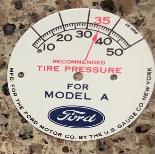

Post by Dropacent » Thu May 20, 2021 11:21 pm
Posts: 8697
Post by TXGOAT2 » Fri May 21, 2021 10:04 am
Aren't Model As about 500 lbs heavier than a T with a similar body style?
