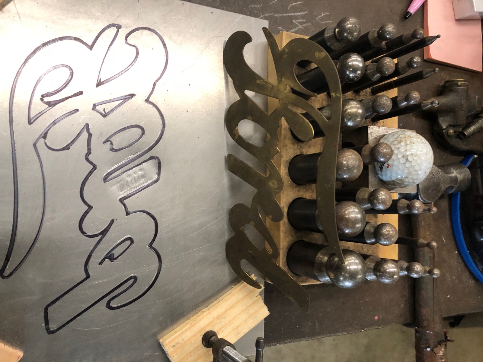

by Henry K. Lee
OK, First I am HUMBLED beyond words by all the private emails! WOW!
Second, If I came across as arrogant, me bad! I missed communicated the point.
Third, Jason, I apologize to you for taking offense. Apology accepted of course.
Let bygones by bygones!
I am going to share some simple tools and process with you all. Look carefully at the photo's. You need a harden ball set (Harbor Freight Tools), an old short railroad spike, old bar stock of various sizes, a good mid size ball pen hammer, 12" X 12" X 1/2" multi layer plywood, some (preferred cloth backed) linoleum, three strong c-clamps, and hopefully you have a steel plate table.
Now after the outline has been established, I like to take a scribe as well to outline better. Taking the railroad spike to a sander rounding the edges since we want to stretch not cut. Lightly strike the outline dead straight on. Note: See how the steel is only being retained on three edges. That's for letting it expand to that open edge only. Now select a round ball punch slightly smaller than the area to be embossed and strike in a slight traveling motion. Keep the angle of strike towards the outside. But starting your work from the inside towards the outside. Keep repeating the process equally as you are massaging the metal. Steel is a different duck as it's shrinking properties are less than other metals. Use the ball punches sparingly as they move metal quickly. Using the old bar stock, rotating the ends back and forth, makes for a long lasting tool. Remember to keep the punches rounded at all times, tearing occurs quick. When you get to your depth required or close to, remove the wood and clamps and very lightly pen with a jewelers hammer. When it looks about right, remove the linoleum a beat straight on the steel plate. Then reverse to do light finish work.
Please note too that legally you can not charge anyone to emboss a logo with trademarks. Ford and others want Big Bucks for some license agreements.
Now don't spend your children inheritance on scrape metal! Make sure if you can, your work area at a waist high zone. This keeps your joints from being trashed.
All the Best to All,
Hank in Tin-A-See

Thanks for the quick description Hank, it looks like a real art form. For someone who just wants to start playing around with a technique like that, would any old sheet steel scrap do the trick? Does it need to be heat treated in any way first to make it more workable?
Re: When The Tin Man Looses his Mind!!
Posted: Sun Mar 17, 2019 10:30 am
by Henry K. Lee
Stay with clean new steel to start, I recommend 22 gauge in the beginning of mild steel. Take breaks and rest your arms and hands.
Hank
