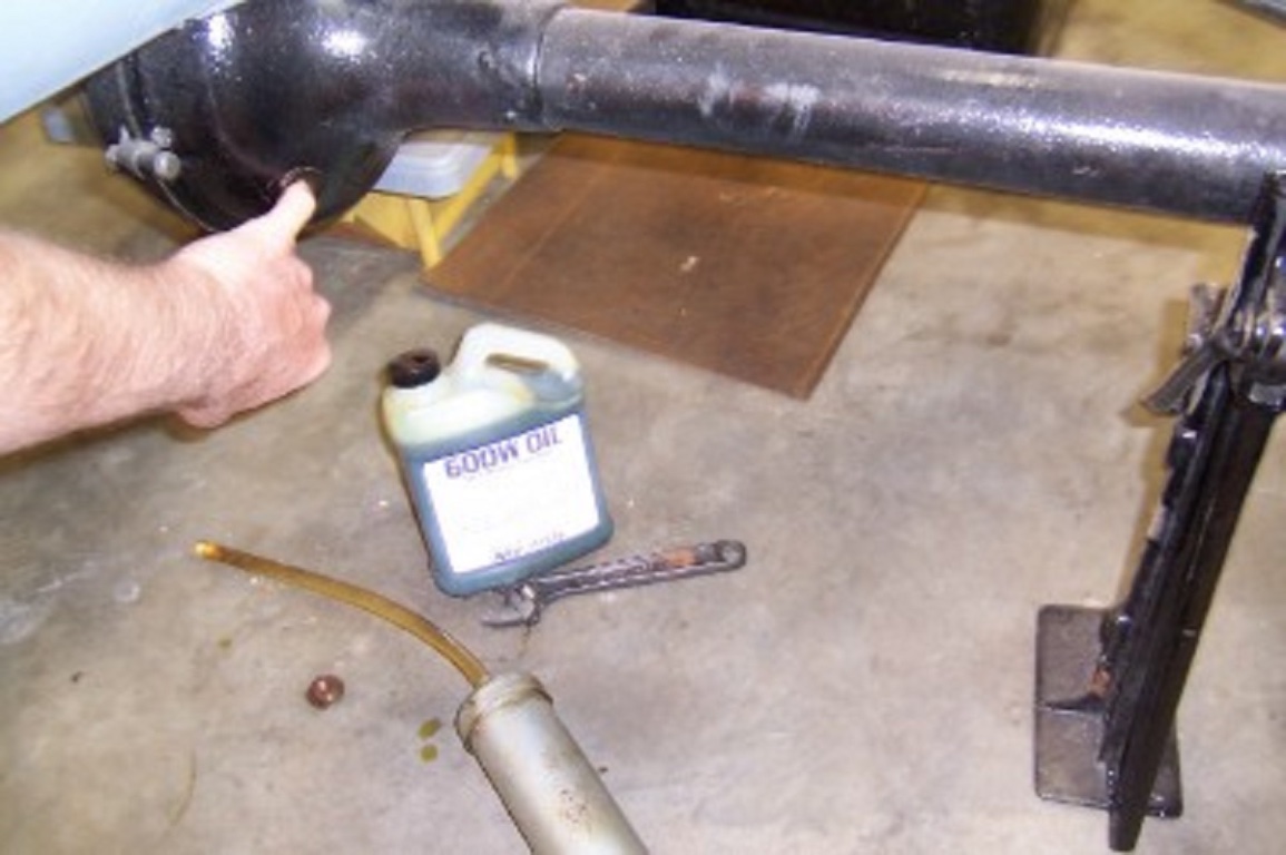

Have done it that way, and used the little pinky to check the fluid level. Some use a bent wire to to it, like a dip stick.
Filling with suction gun, checking with pinky.
