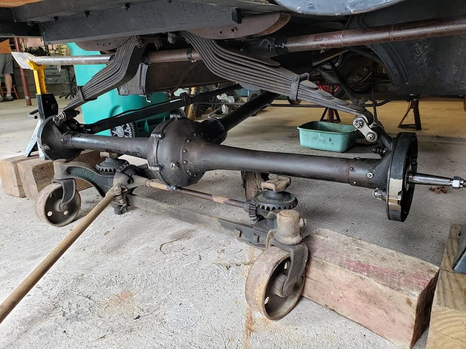

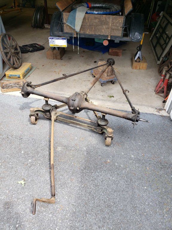

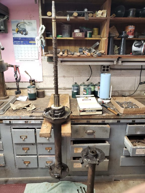

Had a good day getting started on the rebuild of my model T rear axle with dad. It goes under my soon to be on the road 1915 cut down touring roadster pickup. Using some of dad's home made jigs, this is his third axle rebuild and my first. I'm learning and he still is too. Trying to do it right guided by Mr. Chaffin's book.
Today was just a disassembly day. Good we took it apart. Babbitt thrust washers, a sheared off pin at the universal joint, a terrible axle end and other minor maladies were discovered and will be corrected prior to reassembly. Several times today we both said we'd never regularly drive a new to us T without going through the rear. Too many small issues that can be found and caught before they become bigger ones.
I'll update this thread as we go through the process. The axle will be completely refreshed mechanically to make it dependable and SAFE and left alone cosmetically. Thought folks would enjoy a thread like this with plenty of photos to ogle, and enjoy

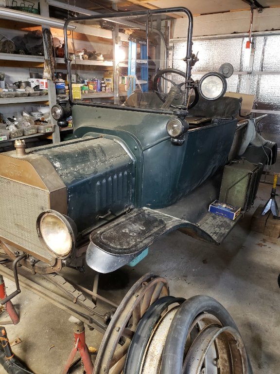

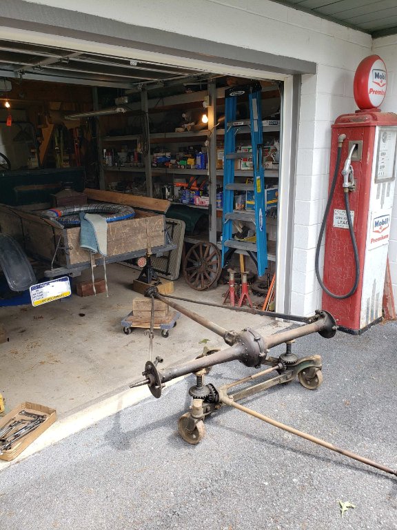

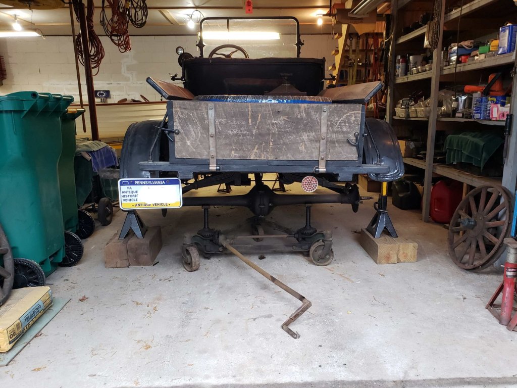

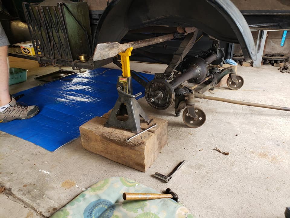

The truck frame and body is safely supported on jack stands and a digging iron made from a New Idea manure spreader axle.
Rolling it out.
Rolling it out.

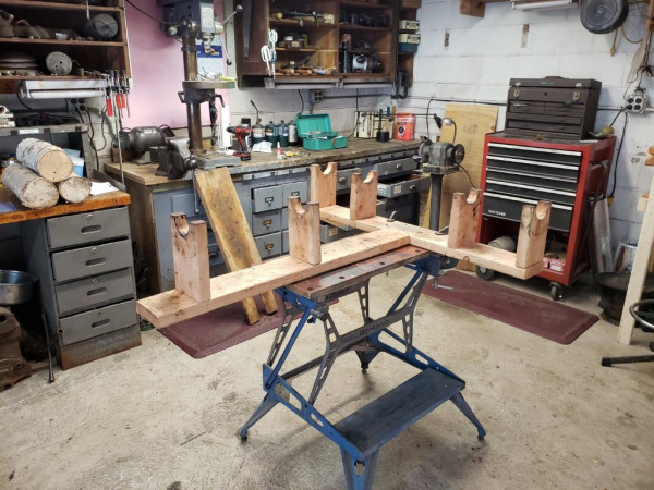

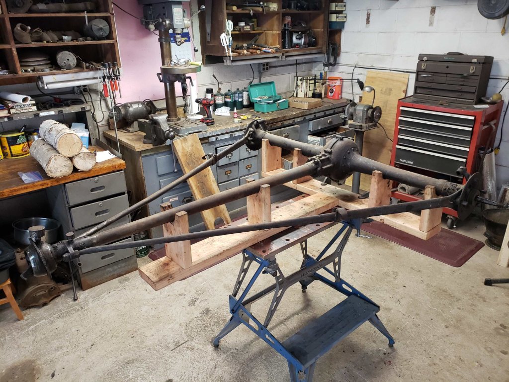

Empty jig...
Empty jig...
Full jig...
Full jig...

Some more shots

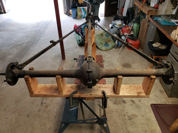

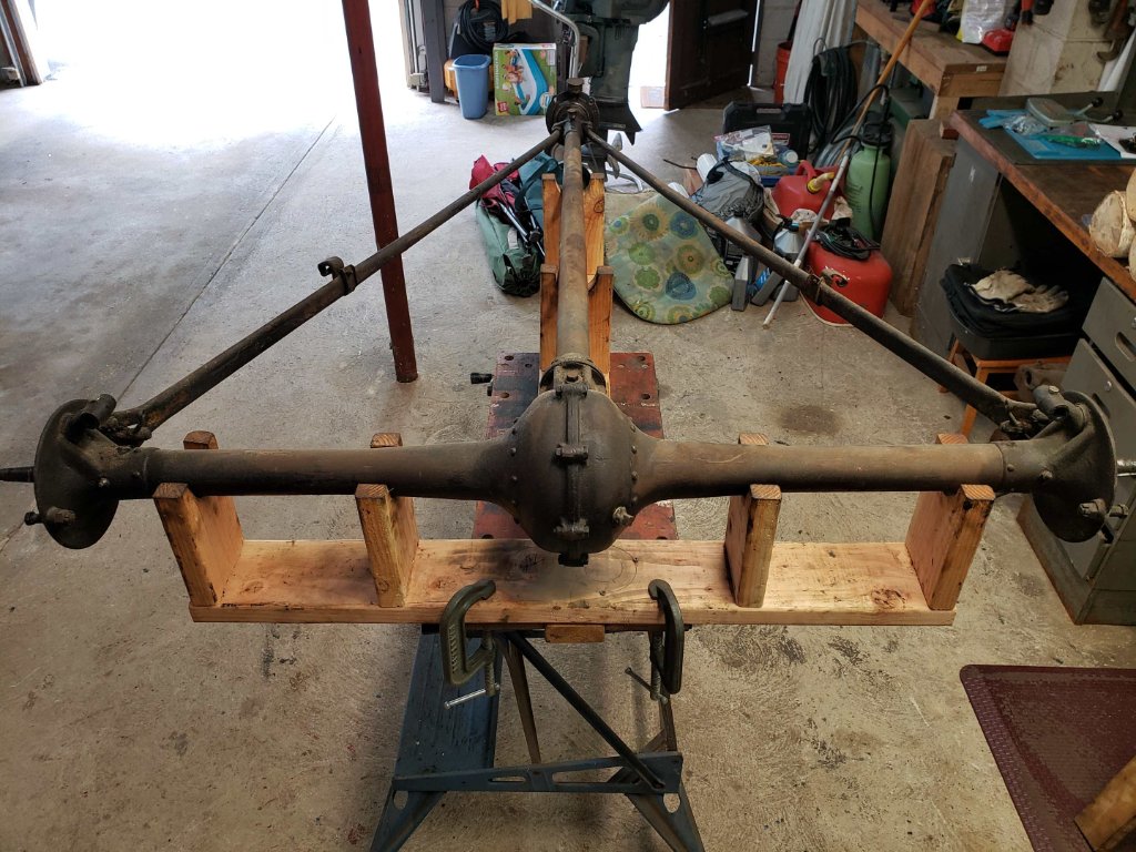

Another shot of the jig, the axle sits in it firmly.

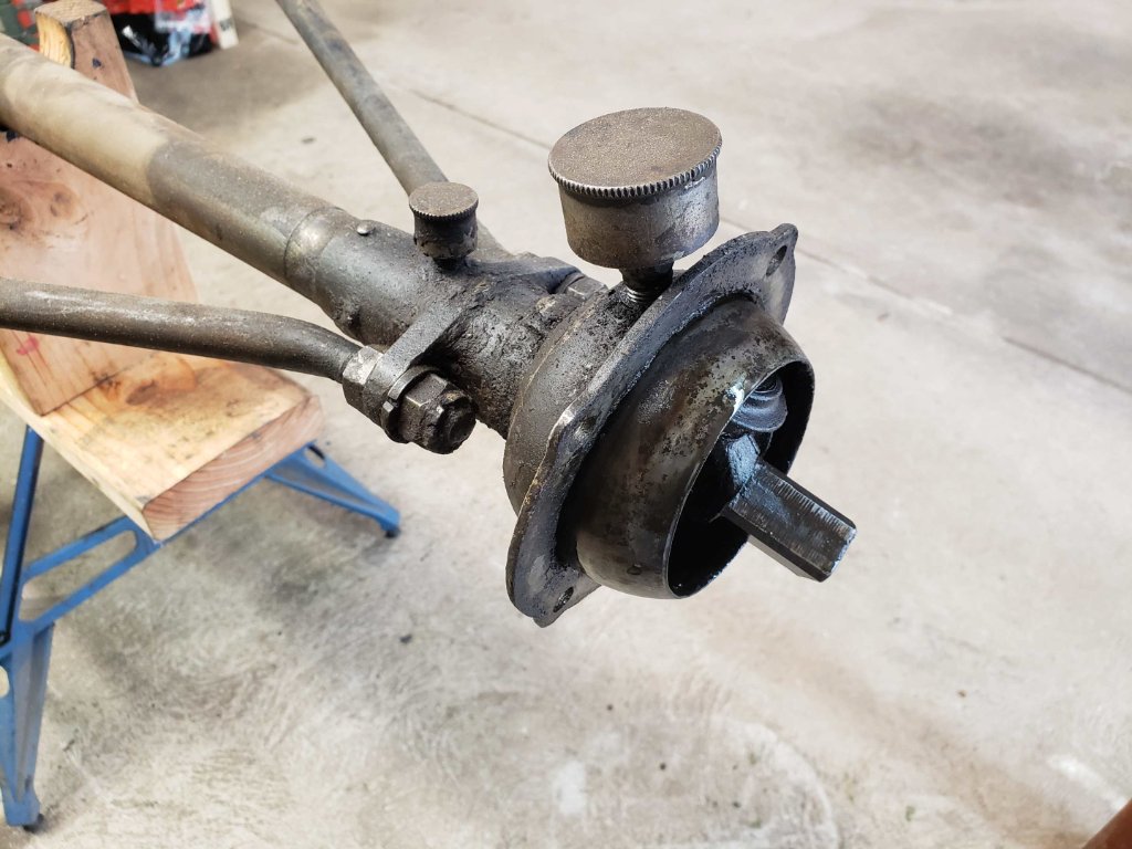

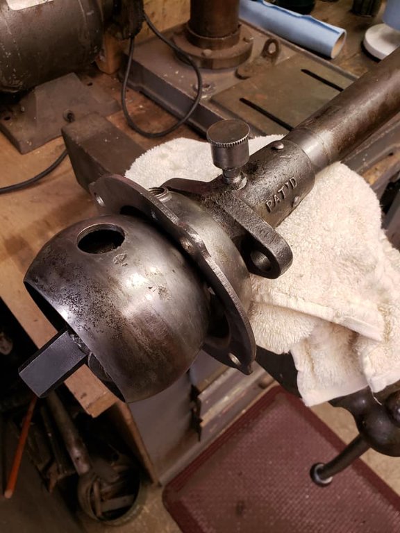

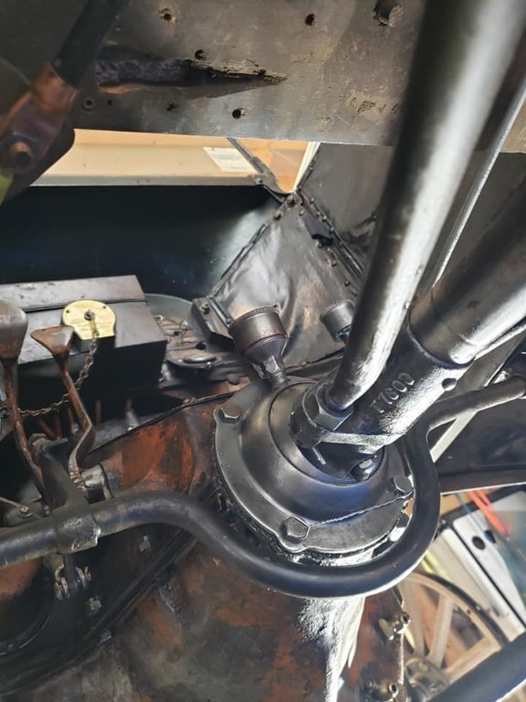

Close up of the rear and drive shaft spool

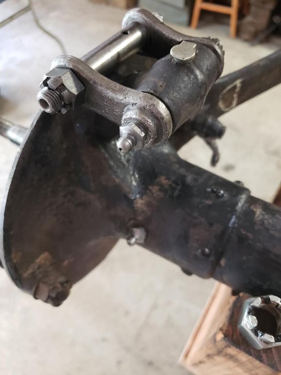

Ball joint end
Ball joint end

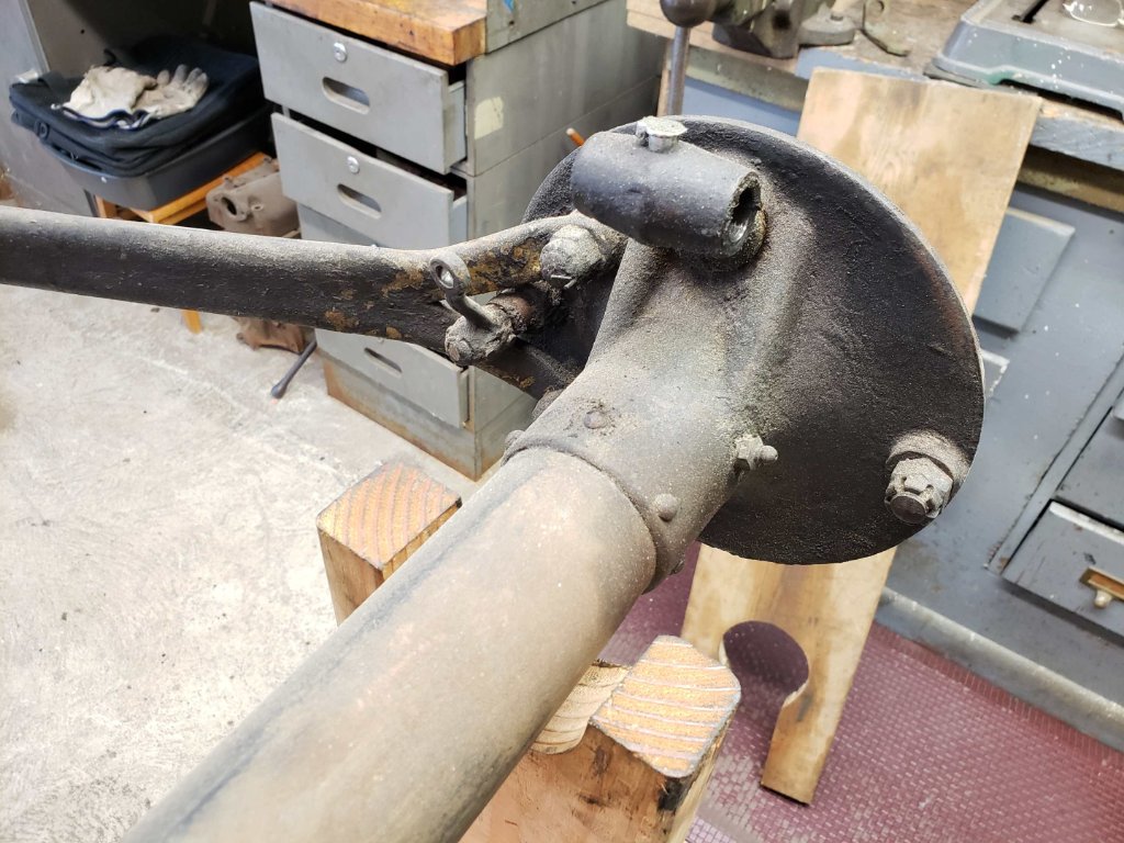

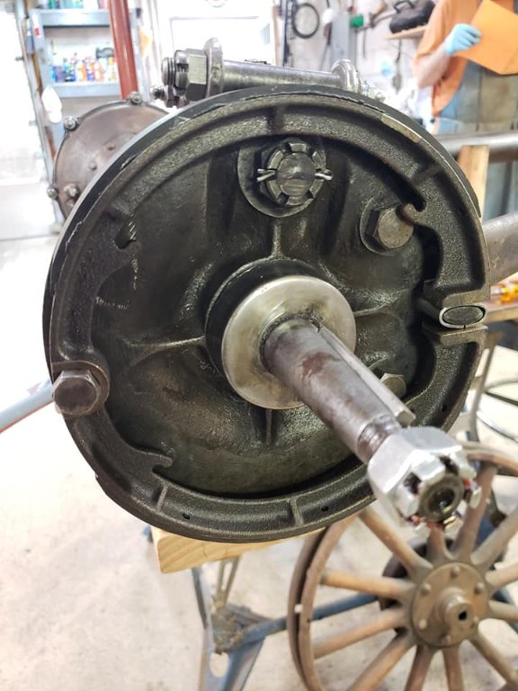

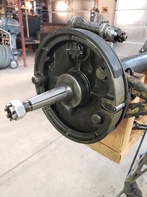

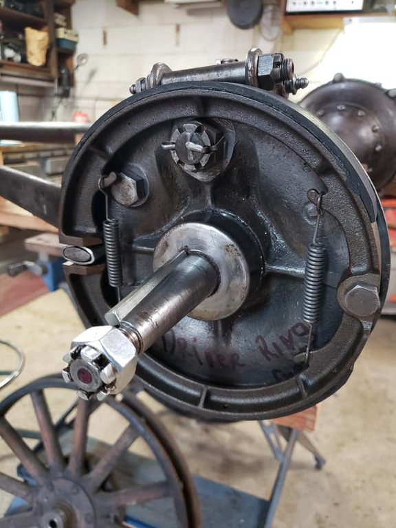

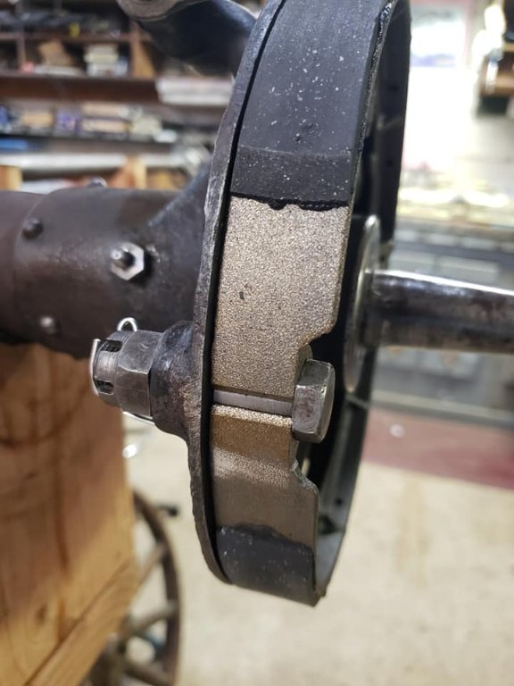

Backing plate.  Might be hard to see, but interesting to see all the brazing at the wishbone connection.

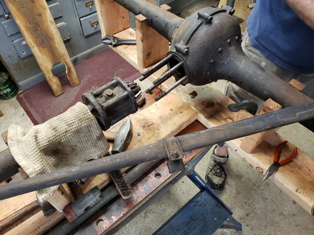

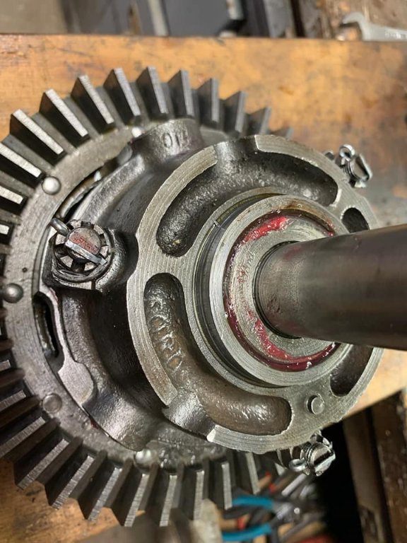

The spool has nuts and studs, not bolts as in later cars.

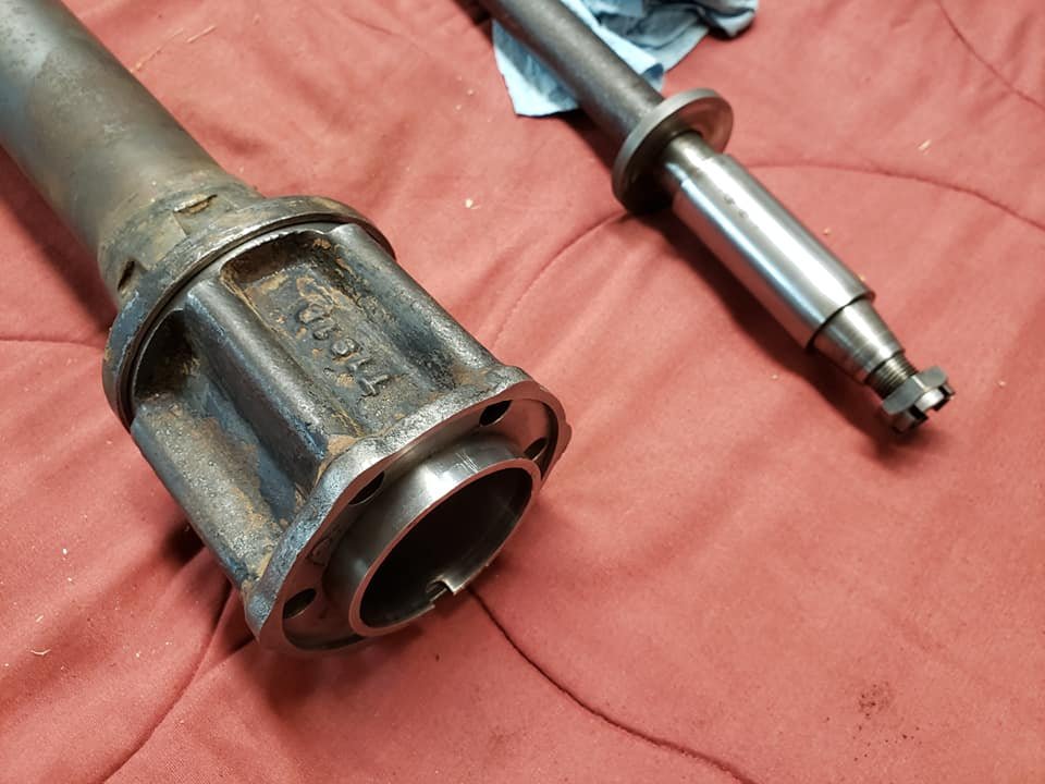

Separating the axle from driveshaft

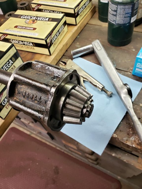

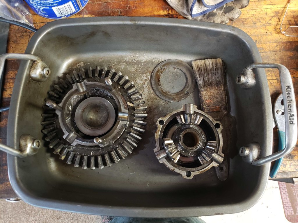

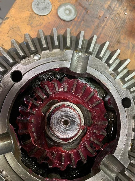

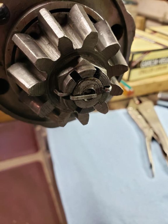

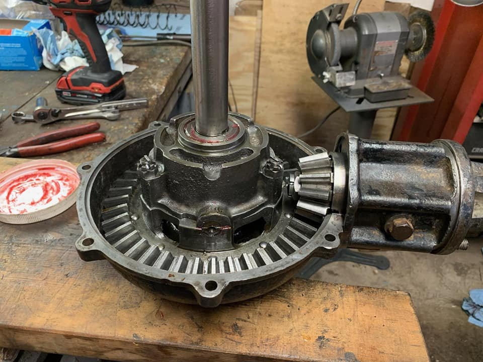

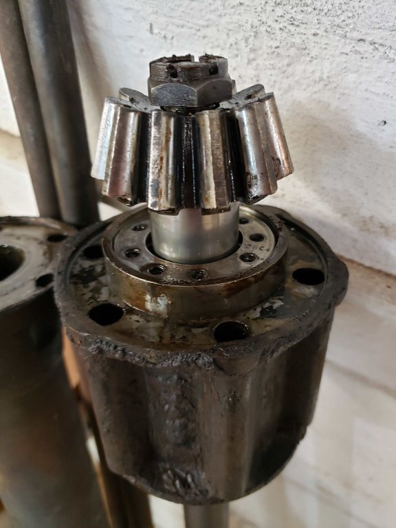

Pinion gear and spool.  Seems decent at first glance, will tell more once cleaned up.

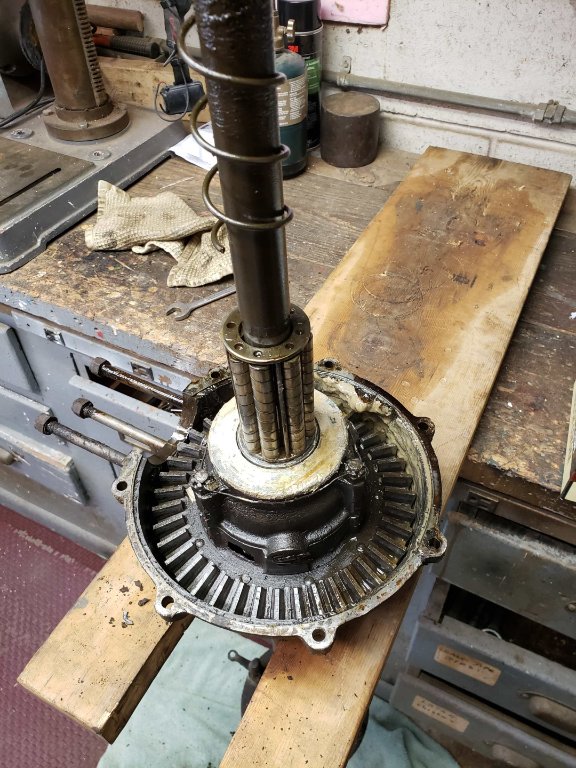

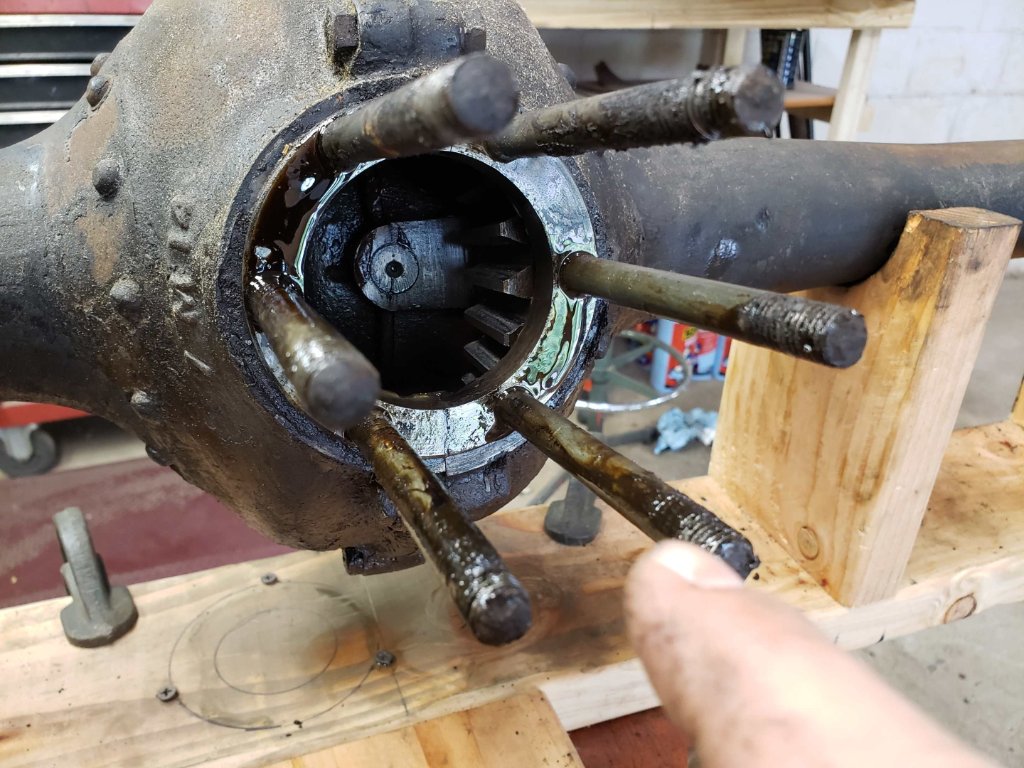

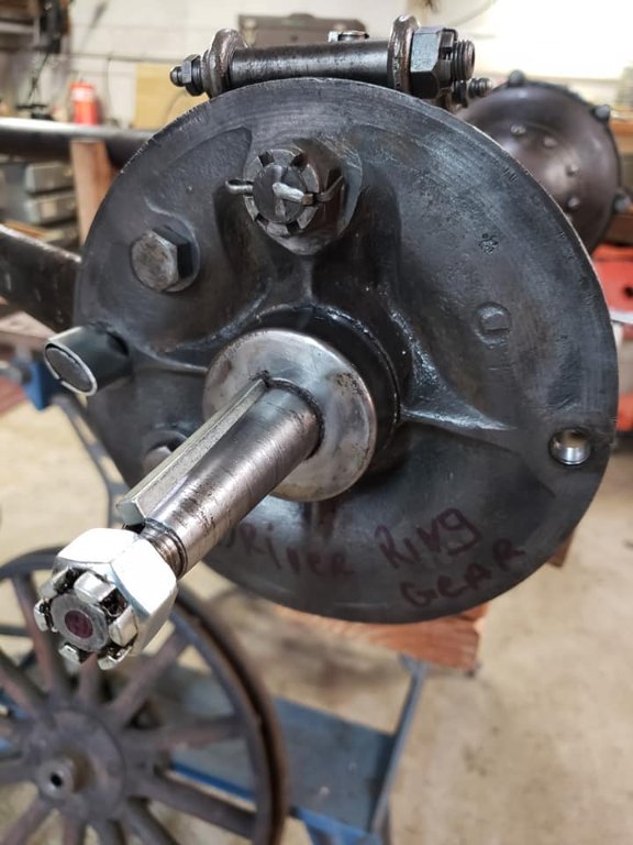

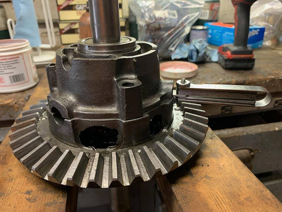

Rear end.  Photo pointing to remind myself which side the ring gear was on.

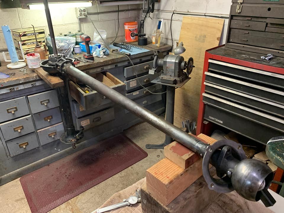

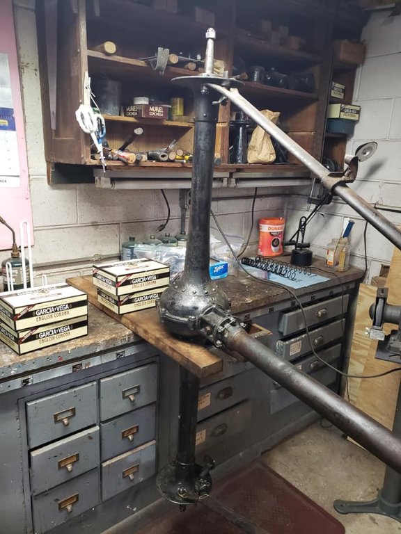

Rear axle jig.  With the wooden plank firmly screwed into the work bench, loosening the bolts to separate the axle halves is a breeze.

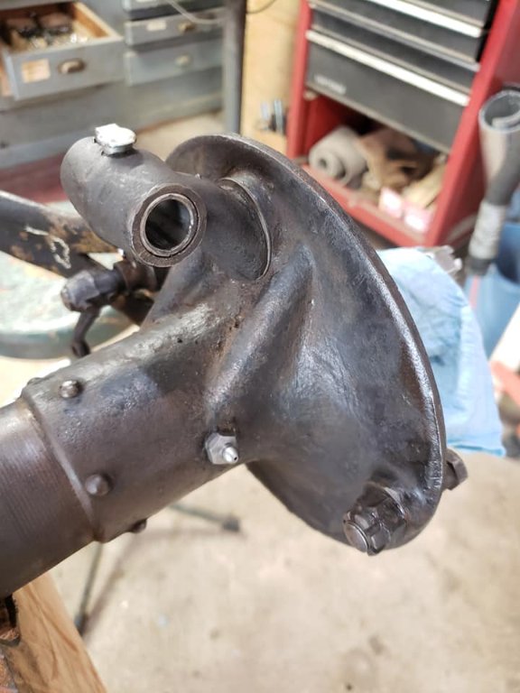

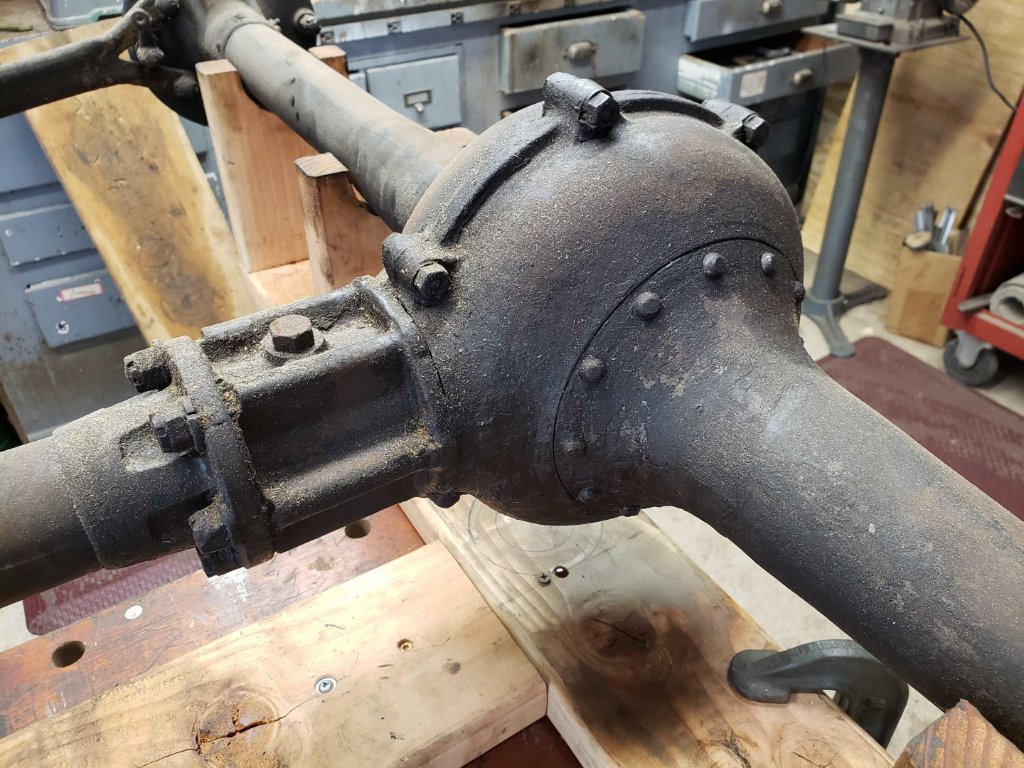

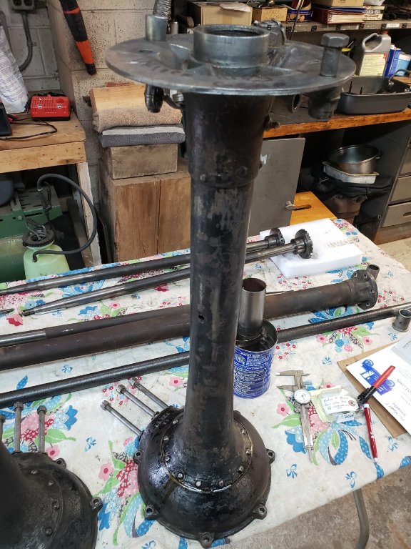

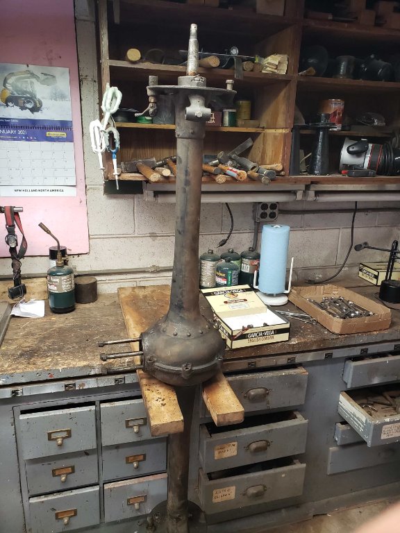

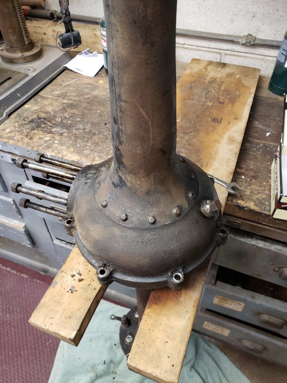

Close up of axle housing

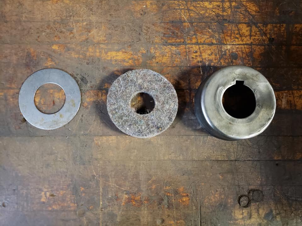

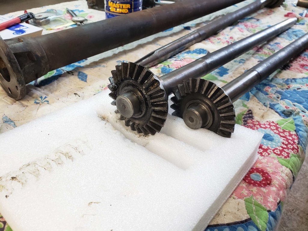

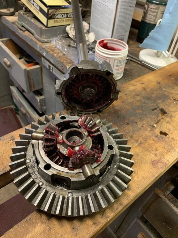

Dad said he thought the springs were accessories that worked grease into the center of the axle as it rotated. Thinking these are accessories, meaning this has been apart before!

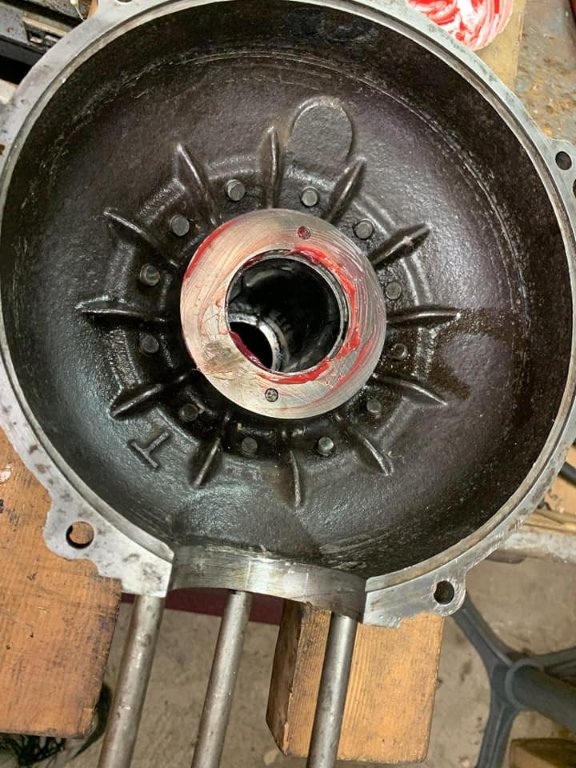

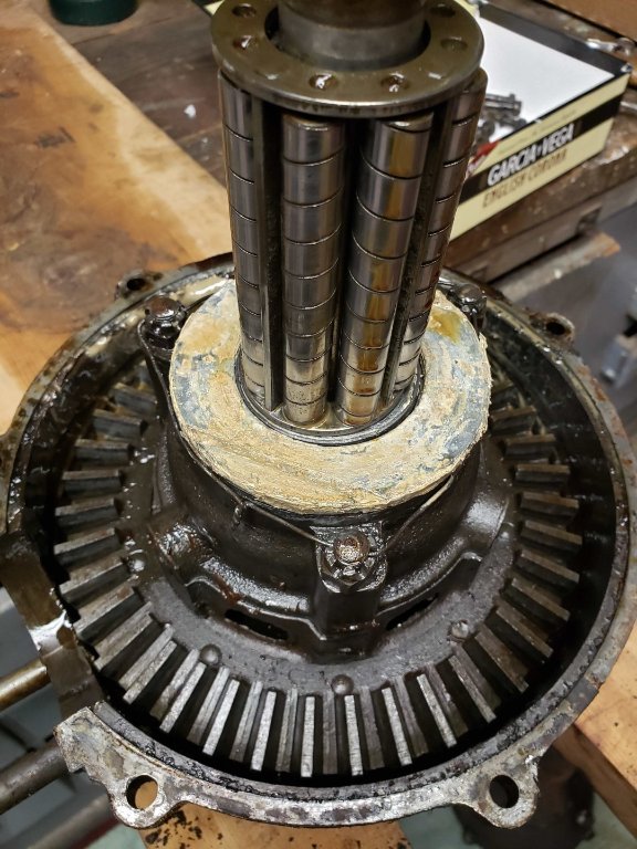

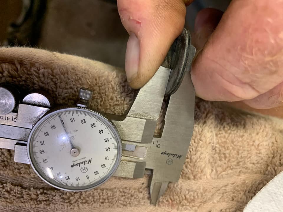

One of the nicest Babbitt thrust washers you will ever find. Little wear!  May have been replaced in the early 60s, which is the last time this car was worked on. Maybe original?  Not very likely.

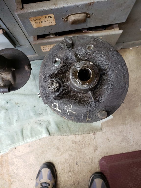

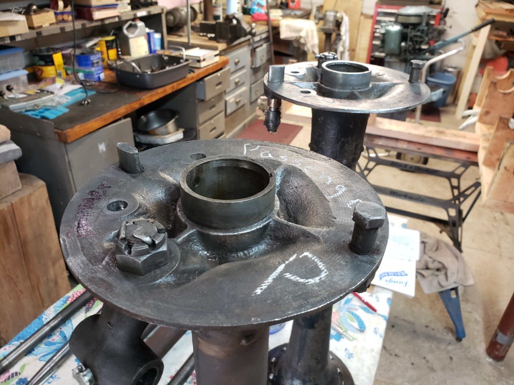

P is for Passenger side... lots of grease to remove.

The other side.  Also a nice, thick Babbitt washer here.  Most of the spools were tight, which is a nice find.  Some races need replaced as expected.

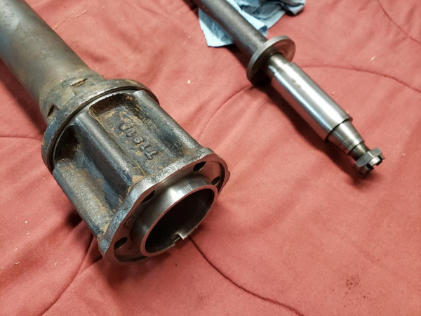

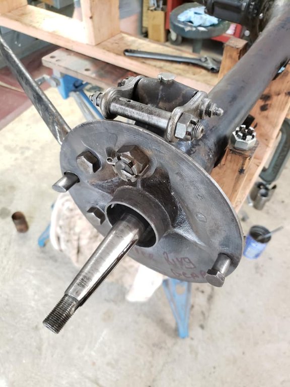

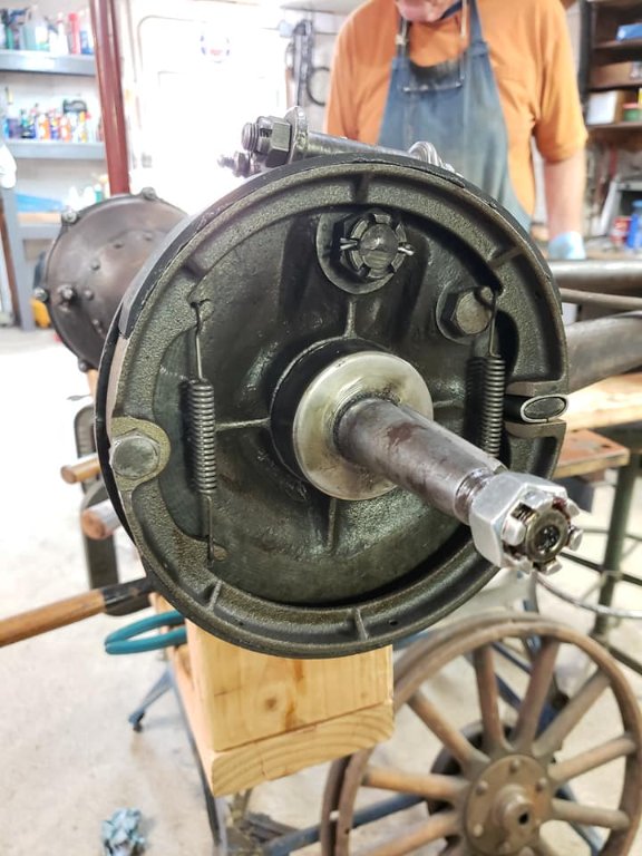

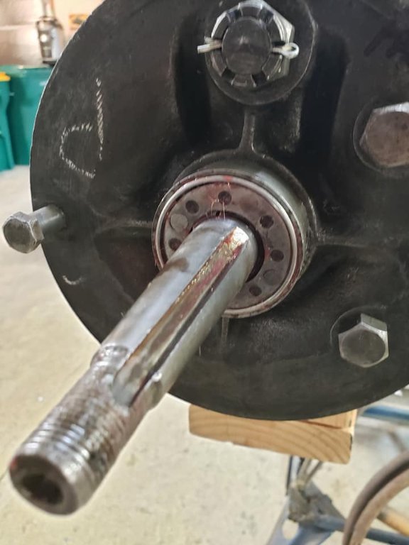

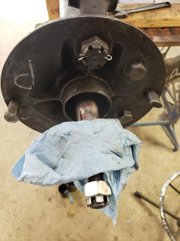

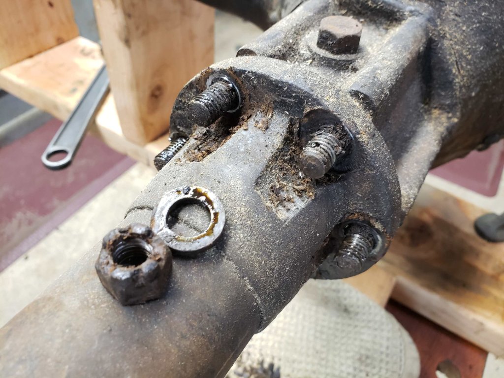

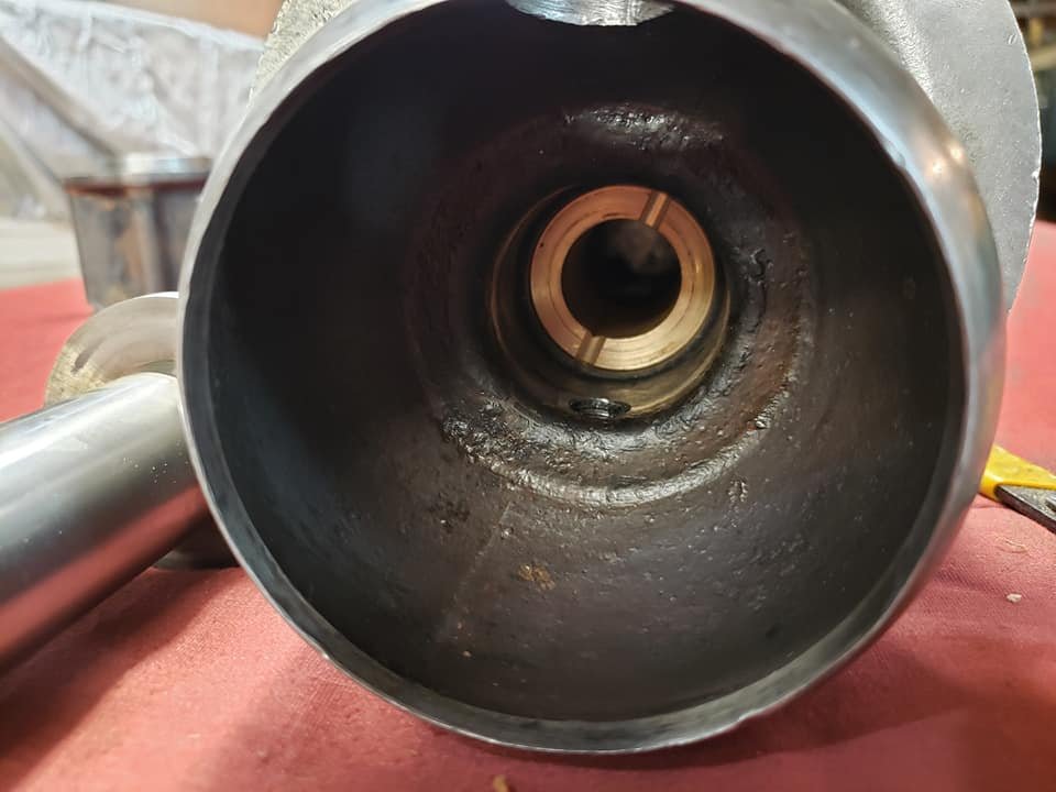

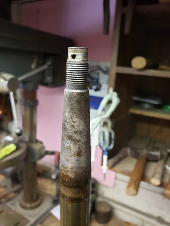

Forgot a shot of the terrible axle end! There should be threads all the way out... right? Haha.. a salvaged axle will replace this one.
Jack Putnam, in Ohio
Posts: 497
First Name: Jack
Last Name: Putnam
Location: Bluffton, Ohio
Re: Cut-down Touring Pickup - rear end rebuild thread
Post by Jack Putnam, in Ohio » Wed Jun 02, 2021 9:17 am

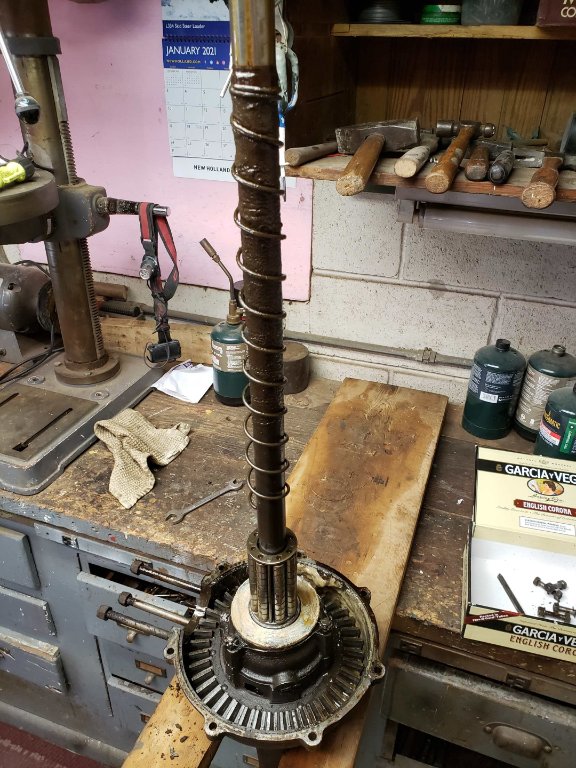

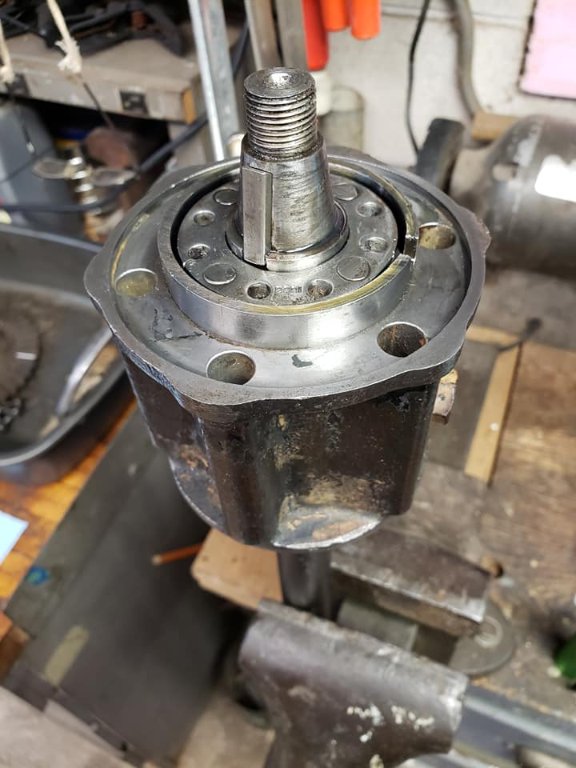

The oil return springs on the axles can be installed by removing the outer bearing on the axle and sliding the spring onto the axle. It was not necessary to split the housings to install.
Retro54
Posts: 590
First Name: Andrew
Last Name: Blaydon
Location: Middletown
Post by Retro54 » Wed Jun 02, 2021 2:54 pm
Good to know! We never installed any, so didn't know. The safety wire doesn't quite look like a nice tight Ford installation, so we are still leaning on this being apart once or so... of not, that Babbitt is like brand new for it to be 1915 oem.

I wonder if the oil return springs will do anything if they are loose around the axle like the picture?

That is what is commonly known as the 1913/'14 style rear end. They were actually used a bit longer than that. Many late 1912 models beginning about July of 1912 used that style, as did early 1915 cars. Both the earlier 1912/'15 rear ends like yours, and the later 1915/'16 rear ends were used randomly from the factory for the first few months of calendar year 1915. Years ago, original survivor cars built as late as June were sometimes seen with the earlier rear ends, however there was always some doubt that maybe the rear end had been changed at some time in its past. Back in the 1960s and '70s, most of the hobby felt a need to correct such "errors" and replaced what they perceived as anachronisms, even though in many cases they were originally manufactured that way. Because of that, a lot of those things mostly don't exist today.
I would suggest keeping it the way it was.
Original era photographs rarely show enough detail of the rear end to know which style the car had. In spite of that, I have seen a few era photographs showing the 1912/'15 rear end in early 1915 cars. If I can find one in the next several days (I have thousands of era photographs saved on my computer!)? I will try to post it here so you could have evidence to support your car as being correct. If I don't post it? I didn't find it (I lost nearly a thousand saved photos to a computer partial meltdown a few years ago).
Regardless how nice those 'Babbitt' washers look? DO NOT USE THEM! They were alright a hundred years ago. And if they did fail, at the speeds and on the roads of the day? One limped it home, no harm, no foul.
Unfortunately, the metals used in that 'Babbitt' mix, are seriously susceptible to chemical reactions over the years that have made the 'Babbitt" brittle. How brittle varies from one washer or rear end, to the next. There is no safe way to know if any one of them is marginally safe to use or not. So replacing them is the only right thing to do.
I put Babbitt in '--' because although the material is technically Babbitt, it is not the same Babbitt as used in a model T's bearings. And the reason "Babbitt" is capitalized, is that it was named after the fellow that invented the stuff back in the early/mid 1800s.
Wayne, thank you so much for the wisdom and info! Much appreciated. Yes, the Babbitt is being replaced, that is one of the main reasons for disassembly, although everything in the rear is getting disassembled and cleaned and inspected before reassembly.

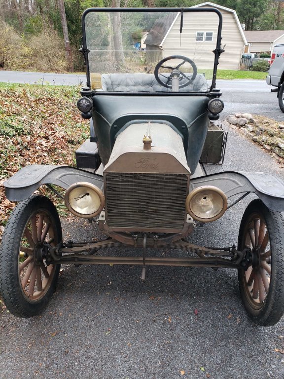

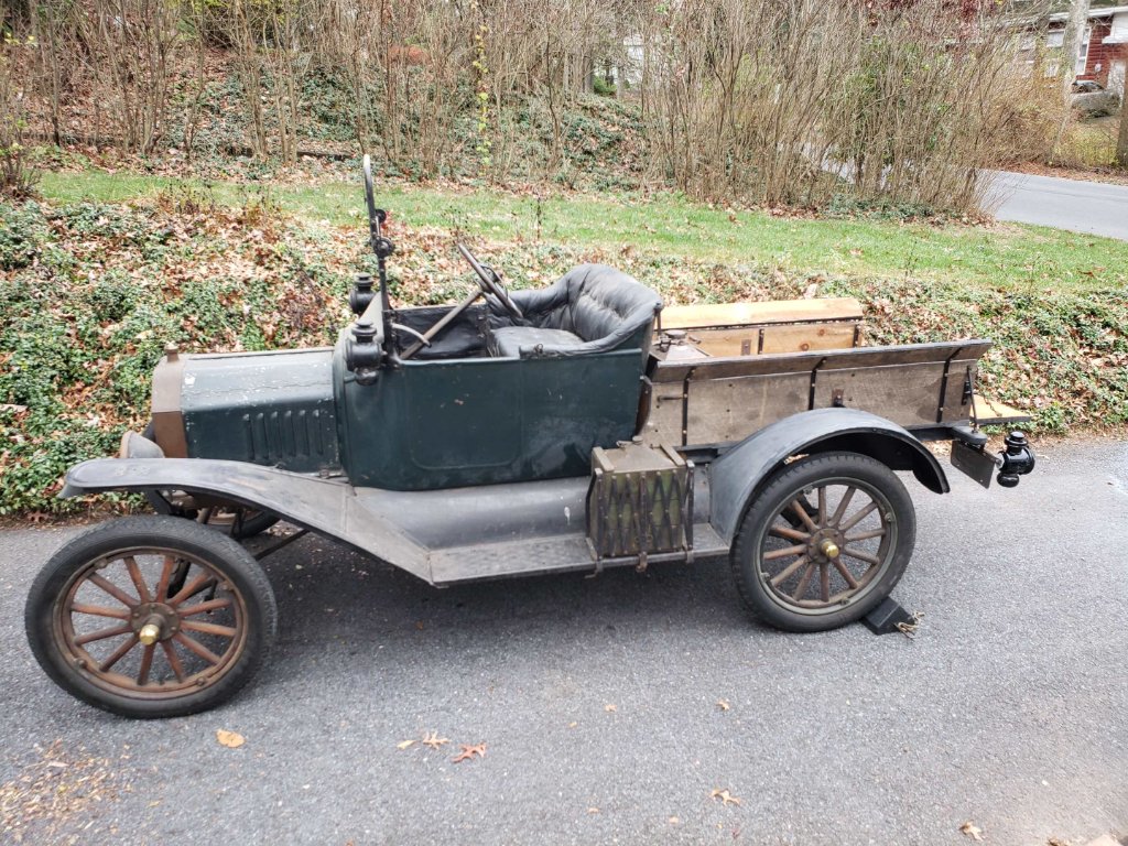

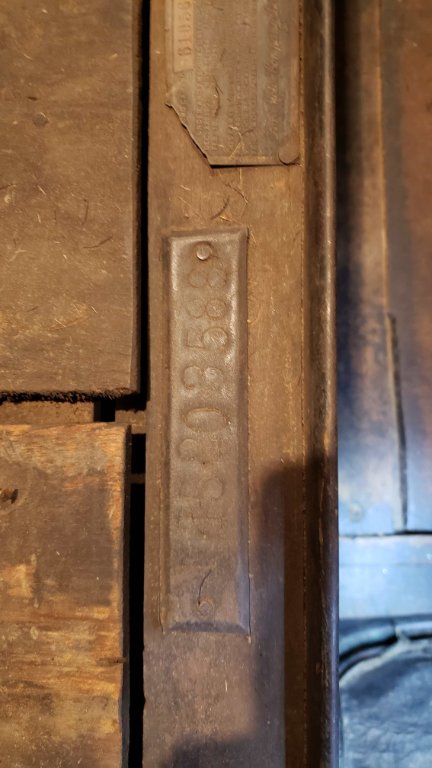

This car is a January 1915 Beaudette touring. While the engine was replaced sometime before 1962, the remainder of the car does not show signs of being 'pieced together' and has enough of the 'right parts' for a car being assembled in the early part of the 1915 calendar year. That being said, it is a cut down touring and the back half of the car and rear fenders were long gone before I got it. I really, really appreciate your information on the rear axle in reference to 1915. Jibes with what I've read on Royce's website and other post regarding early model year 1915 cars.
I would really enjoy seeing the period photos and look forward to seeing one of you can find them. If you frequent Fall Hershey, you'll be able to see the car in the Chocolate field and I'd enjoy meeting you.
Andy
The body plate nailed to the top of the front seat riser.
The car with a truck bed dad and I built last year.

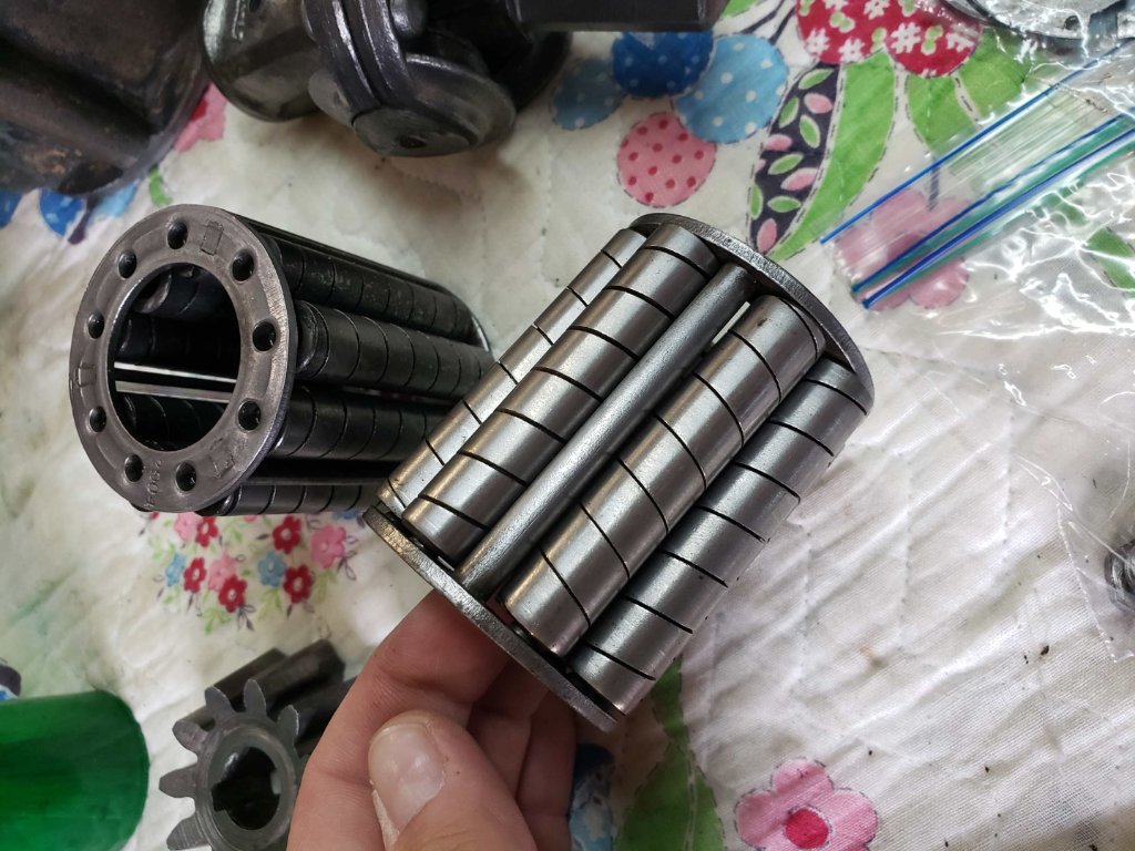

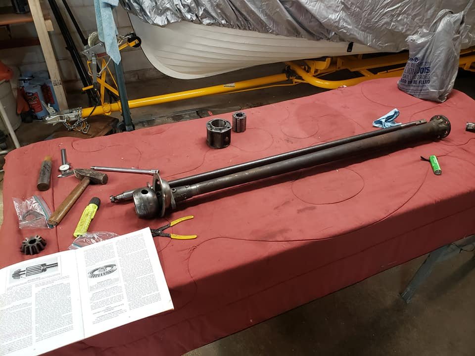

Got back to the home garage on Friday and spent a relaxing afternoon with Dad, taking the last of the rear axle apart, organizing parts, and checking some against tolerances to see if they need replacing. Sure is coming along ! Dad has been working steadily cleaning things up between the last time out, which helps me out a lot staying on track with getting this back together. Not much more cleaning to do, soon it is time for reassembly! I'll post some photos in a few minutes showing the progress. Not too much to see, but everyone likes pictures right??
Andy

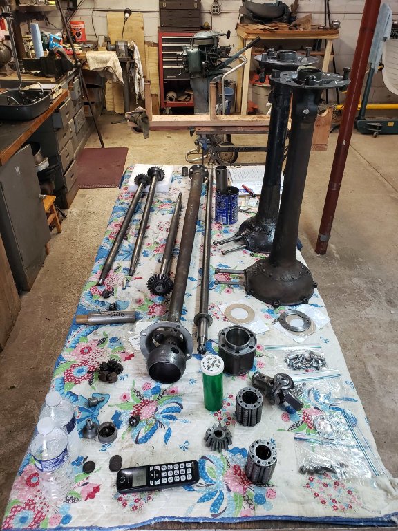

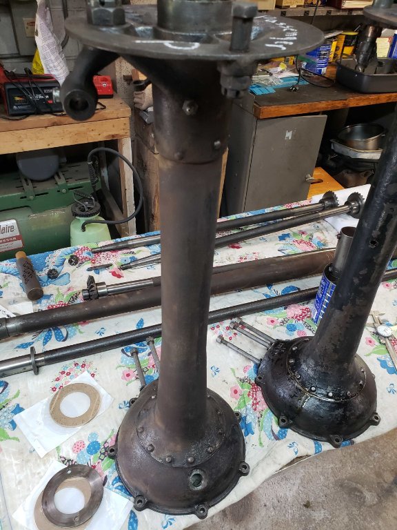

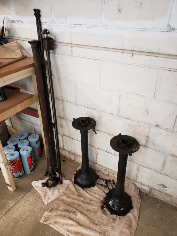

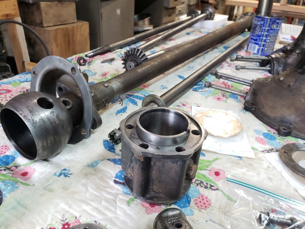

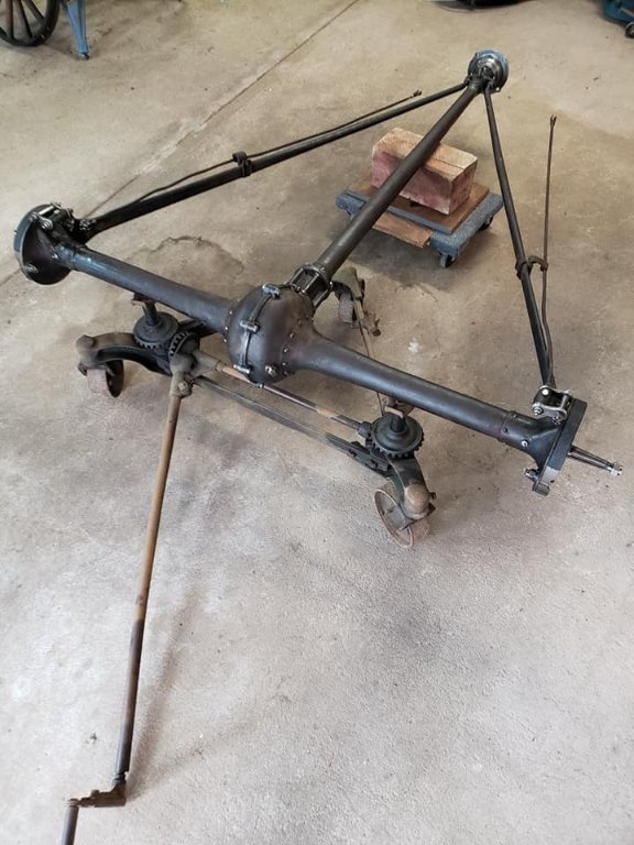

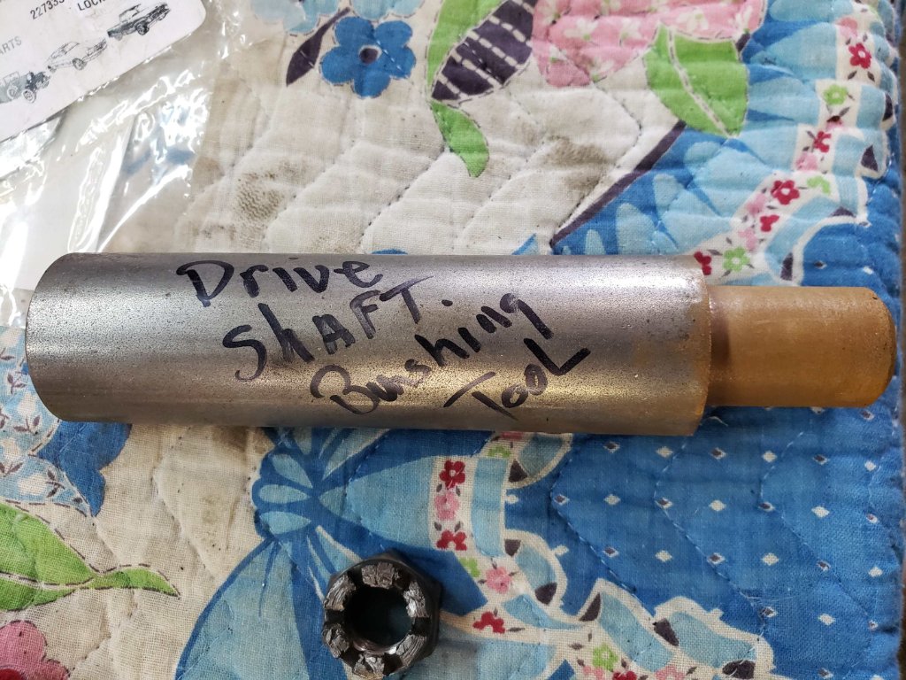

Just about all the parts for the axle laid out and being checked
Axle housings. These are the 1913/14 style which were phased out over the 1915 model year. This helps to tell the tale that this car is an early 1915 production car.
Label everything, and take pictures!

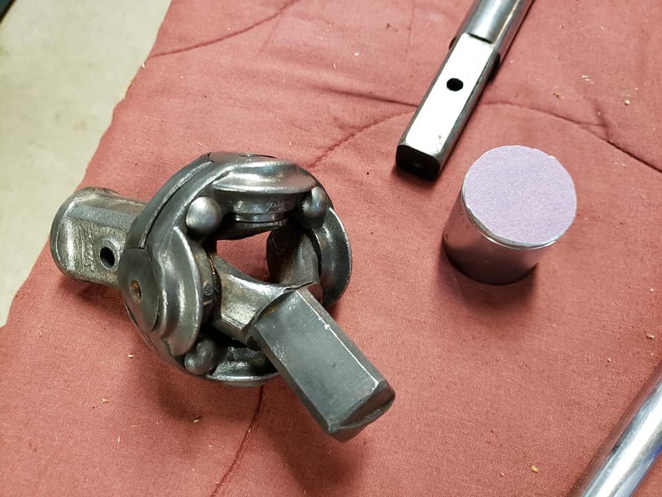

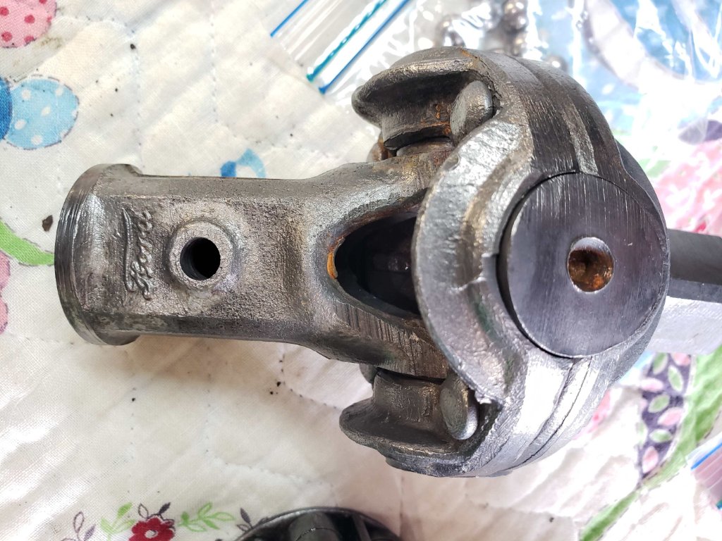

Original FORD Universal joint, checked out within tolerance and will be used again.  FORD labeled everything!

More pictures! That took more than a few minutes!
Driveshaft housing and spool.
Driveshaft bearings.  The one I am holding is a nice and tight replacement for the original one in the back which was rather loose.
It helps to have the right tools for the job.
Replacement driveshafts. Not as worn as the ones in my car. It is helpful to have a dad and brother who have collected lots of spare parts!
KitchenAid makes the best degreasing pans!  Ring gear and spider gears ready for cleaning.

The car... awaiting the rebuilt rear axle and new rubber!

Got out to dads garage July 3rd and got the new wear parts installed in the the driveshaft and the driveshaft ready to go back in the car. Next time will be the rear axle and housings. Getting there!
Clean parts ready for assembly. (Thanks Dad!)
New brass bushing installed in the housing.
The housing and spool. The silver end of the driveshaft to the right rides on a bearing in the spool to the left.
Universal joint, driveshaft end and 13/16 socket with sandpaper glued to it we used to face the brass bushing to meet tolerances..

Driveshaft in the spool ready for pinion gear.
Pinion gear installed and nut torqued.
Proud of my text book cotter pin installation.
Universal joint installed.. All ready to go!

Drive shaft pix shows 1 washer. Should be 3 pieces. 2 thrust washers & a caged ball bearing between.

You didn't catch my joke... on these earlier ones there are two 'race washers' and 15 free floating ball bearings. Not shown in the photos to protect the innocent.
Posts: 5253
First Name: john
Last Name: karvaly
Location: orange, ca
Post by speedytinc » Tue Jul 06, 2021 8:10 am
That explains it. I see that now. I dont use this type too often. Thanks.

Post by Retro54 » Sun Aug 08, 2021 9:42 pm
Some more updates from the last few weeks of Re-assembling the 1915 era rear axle for the RPU. Gonna be a big photo dump, as it's in the truck now.
Spider gear in the middle, ring gear on the outside.

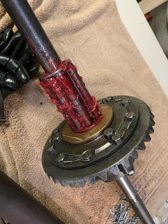

Carrier being put back together. Feeler gauge trick is one from a Stan Howe post.  Put your two axles in and keep inserting progressively thicker gauges until you get the desired backlash. Then you know how thick your disks between axles need to be. Brilliant and simple, just like Mr. Howe.
This little disk goes between each separate axle and the thickness has to be altered to eliminate backlash on the differential. Time consuming process, but as I said above, brilliant and simple. Here we are measuring to match thickness per the feeler gauge.
Spider gears installed.

Next steps in our process!
Carrier back together.
Inner roller bearing lubed up with Lucas Oil Red n Tacky grease.
Other half of housing with lubricated thrust washer.
Back together again! Dad is very proud of the drag and backlash he was able to achieve. This rear meshes like new!
Half way there!  Bench top jig on display.  Attached to the work bench with wood screws through the jig.

Next Steps in our process... we are not cigar smokers.. but a neighbor is! The boxes make great parts storage units for parts such as those on the rear axle. Each box is a different sub-assembly and different side of the axle.
All back together and ready to be set on the table.
Rear hub, ready for outer roller bearing and new brake shoes.  We are not afraid to label parts, such as the backing plate, in hard to see locations with Sharpie markers. Helps keep us from making mistakes.
Shackle all cleaned up with new bushing. A previous owner placed zercs in the end of the shackles. I love the servicability of this, and so am not changing it.
New bushing and backing plate cleaned up.

Other side, ready for sleeve and bearing!
A roller bearing greased with Lucas Red N Tacky grease is back home in a new sleeve and supporting the axle end.  Fun fact, if you do not get the new inner seal seated correctly in the axle housing, the sleeve will not go in far enough and even if it LOOKS right, that darn roller bearing will not go in.  We learned this the frustrating way, but knowledge gained is knowledge earned!
Once the bearing goes in, then from left to right goes... 1. A thrust washer 2. A felt washer. 3. An original dust cover (they do not reproduce these for the early rear ends).
Dust cover and key installed.
The other side with dust cover, key, and a new set of emergency brake shoes!  Can a sharp eyed expert see what I did wrong with the brake shoe in this shot? Sometimes you need to install twice to get things right!

And yet another set of photos... these rear ends are a lot of work! haha
Another angle. A shim was added to the brake shoe cam to take up some of the wear on this original part. I think the show is still installed incorrectly in this photo...
The new emergency brake shoes (From Langs) have a lining bonded to them. The original ones are just metal as we all know.  With the service bake is located in the transmission, having good emergency brakes is a minimum necessity to ensure safe driving. A set of auxiliary bakes are certainly in my future, but not right away, need to get the car complete first and then spend $$ on extras.
Drivers side completed and ready to go!
Passenger side as well. Now it is installed correctly!  I had the brake show fliped, so the dished out area of the shoe for the pivot bolt was against the backing plate.  Doing so does not allow the installation of the cotter key on the packing nut. Learned this lesson! haha

Now to get this thing in the car. My brother (Also a member of the message board) has a Weaver Twin Auto jack. He lent it to the project and that's what we used to install and un install the axle. What a life saver! Such a simple tool makes installation much easier! Now the next step is to paint my freshly sandblasted and primed rims, retrofit the new rubber stem tubes with old metal schraders, and mount the Universal T Drivers and then learn to drive the darn thing! haha. I can't wait. Hope people enjoyed looking at all the photos. My father and I are not anywhere near experts, but with this being his third rear he's rebuilt, we keep learning a bit each time (Mostly from manuals and other users on this board). Cheers!
Using the Weaver Auto-Twin jack makes axle installation a breeze! Just add a Harbor Freight dolly and one can roll the axle underneath by themselves.
In the car!  The car is supported on my Grandfather's old digging bar made from a New Idea Manure spreader axle.  Real good steel, real heavy and perfect for supporting the back half of a T.
Universal joint mated to the engine.  While the car is a 1915 touring body, frame and axles, the engine is a 1922 model, painted orange at some point in its life.
She's in and ready to roll!  Very happy to have the car back together again and hopefully drivable by Hershey!
