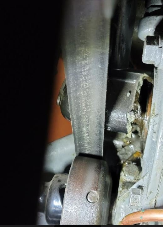

Post by stevensprenger1 » Sat Jun 12, 2021 5:28 pm

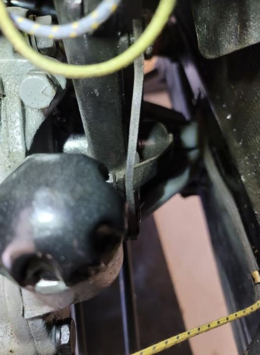

I recently purchased a 1926 Roadster. When attempting to start, I managed to do some damage, but I'm having trouble identifying what I need to purchase to repair. It's by the timer, but it's not the timer and I don't believe the cap.

Re: How bad is this?
Post by speedytinc » Sat Jun 12, 2021 5:37 pm
Take another pix back further & the other side also. I cant tell what that is. Clip on Distributor base?

Ok, so now I'm thinking it is the timer cover, it just appears different than others I'm seeing online. Does anyone know which specific type this is?

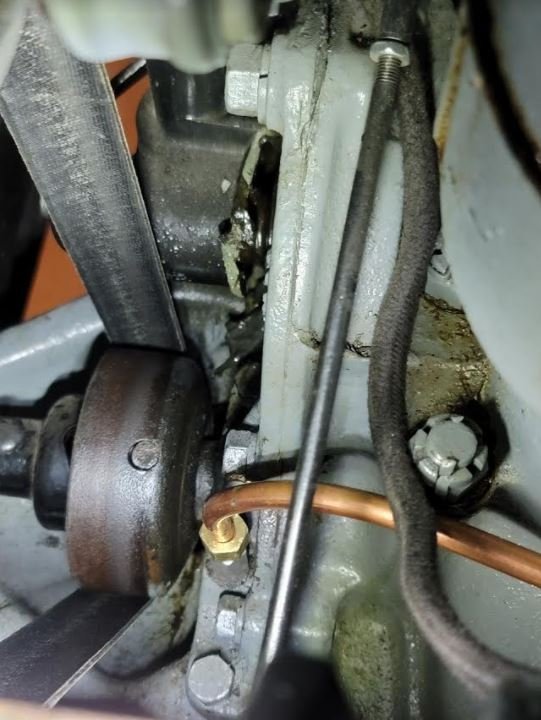

Post by stevensprenger1 » Sat Jun 12, 2021 6:50 pm

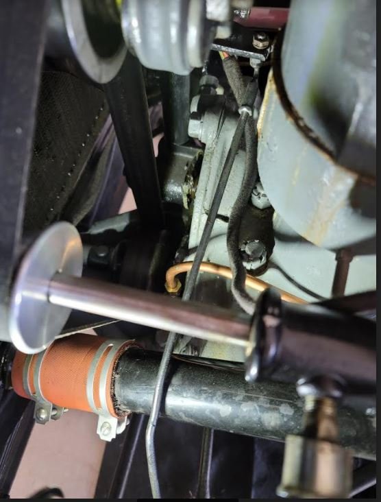

I need to get another pic from the other side, but here's one a bit further back
Post by stevensprenger1 » Sat Jun 12, 2021 6:54 pm

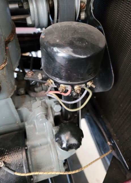

Here's another from further back
Kerry
Posts: 1464
Last Name: van Ekeren
Post by Kerry » Sat Jun 12, 2021 7:00 pm
Your last photo shows it all, it's an after market part, a distributor has been fitted to your engine, now will need some photo's of the other side to see if period one or a modern one.

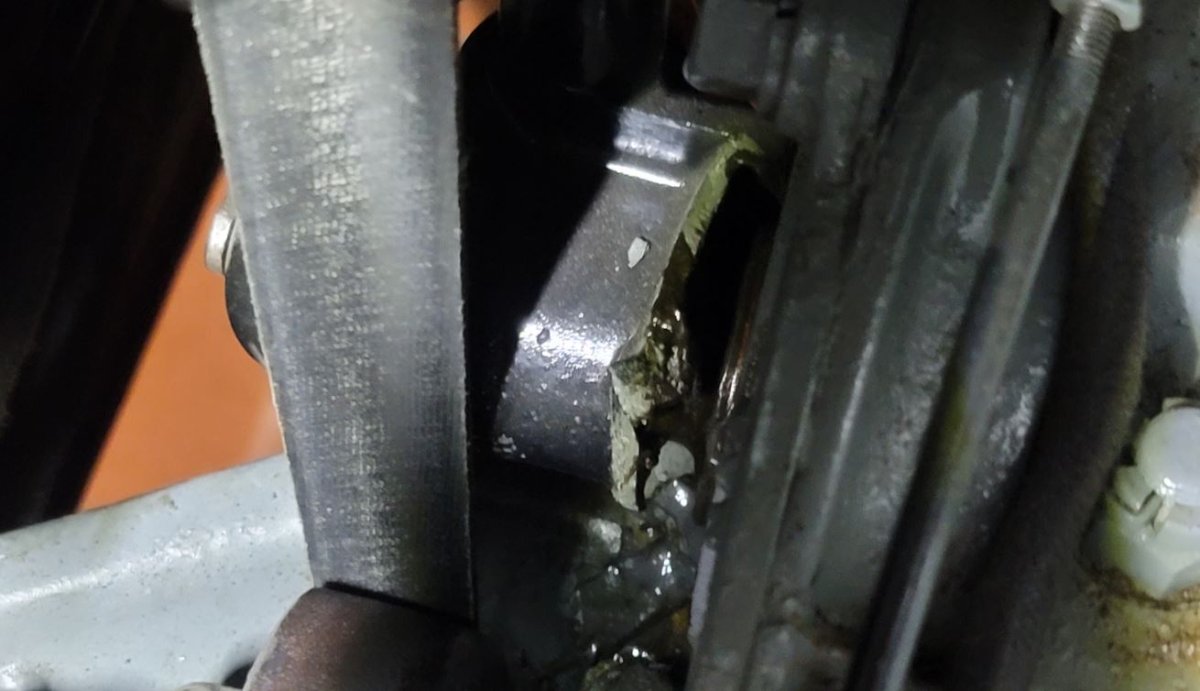

Post by stevensprenger1 » Sat Jun 12, 2021 7:16 pm

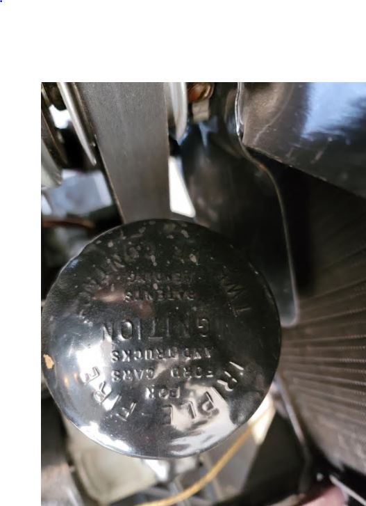

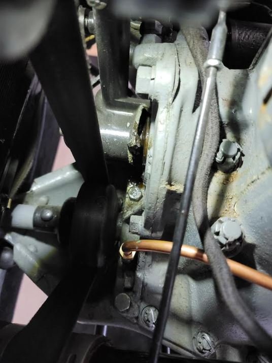

Here are some more pics. I couldn't really get a good shot from the other side, but tried. It seems to be a cover for the timer/commutator, but I'm not seeing the same type online. Not sure where this one came from...

Post by stevensprenger1 » Sat Jun 12, 2021 8:01 pm

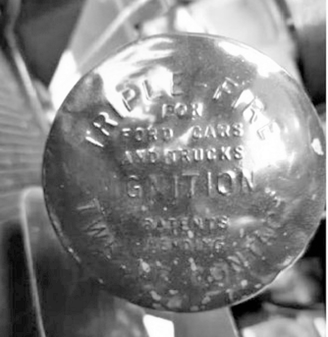

Thanks for you help. I didn't realize it was all part of a distributor. Looks like it was made for Fords. Hopefully, I can just buy the part that broke rather than an entirely new distributor kit. Thanks Again.

Post by RajoRacer » Sat Jun 12, 2021 8:09 pm
WAG - it's an elevated accessory timer or could be a distributor - it's done for !
Posts: 7322
Post by Allan » Sat Jun 12, 2021 8:25 pm
Steve has it, an old time accessory, probably a raised timer. of a brand with which I have never seen before. A replacement will be difficult to find, and if the broken bit is diecast potmetal, not likely to be repairable.
If it's just a timer, the fix is easy. Replace it with an Anderson or another of your choice. Hopefully, all you need to do is re-route the existing wiring.
Post by Steve Jelf » Sat Jun 12, 2021 11:47 pm
I agree, it looks like some kind of accessory elevated timer, and it's toast. I expect finding another would be somewhere between difficult and impossible. I'd replace it with a normal timer — Ford, Tiger, New Day, Anderson, etc. I prefer New Day.
Post by kmatt2 » Sat Jun 12, 2021 11:52 pm
From the wireing in the last picture it looks like a timer elevator. This would mean you are using 4 stock Model T coils. If so, you can get a new timer from T parts vendor. You will also need a new timer advance rod because the old one will be the wrong length. A optional choice would be to get from T vendor a replacement clip on distributor with new coil and spark plug wires. If it were me I would stay with the 4 stock Model T coils if your car was running ok on them.
Post by TRDxB2 » Sun Jun 13, 2021 2:17 am
How bad is this? Really Bad. BUT the good part is now you have something to work on
Enhanced photo right side up. Might need a new set of wires too - may not be long enough.
