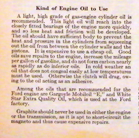

The Model T specification
From https://modeltfordfix.com/care-and-feed ... el-t-ford/ By Royce Peterson
oil weight.png (650.48 KiB) Viewed 9584 times

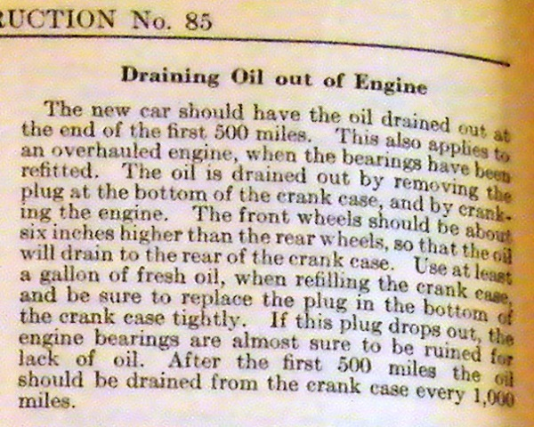

The original specification for the Model T was "light" oil as oil was only defined as "light" medium" and "heavy".T he guys who collect oil cans know the answer, because there was a period of time in the 1930’s – 1940’s when oil cans were marked with both the old “Light, Medium or Heavy” designations and the current designations. ... So we now know the answer. Light = SAE 20, Medium = SAE 30, Heavy = SAE 40
How often?
Since the Model T has no oil filter in which case non-detergent oil would be period correct. Changing the oil in a T should not be limited to draining but should include removing the inspection cover on the oil dip pan now and then . If you haven't ever done it now's the time. Non-detergent oil causes the contaminants to adhere to inside engine surfaces, so don't be shocked with sludge build up.
As Royce points out don't use oil with additives that can be attracted to the magnets in your magneto if you have one. Another consideration is the transmission with its so called "wet clutch", brake and reverse bands. This may lead you to consider Motorcycle oils formulated for that.
In the end seasonal temperatures affect choices as well and multi-grades are always an option. New high performance car engines (My 2 stage snow blower as well) are calling for 0W30. 0 weight is for quick lubrication and easy starting in all weather conditions. Cost and oil change frequency should drive your choice amongst brands and between synthetic and refined/re-refined oil.
So weigh member choices, your location and driving habits, oil parameters and your budget
