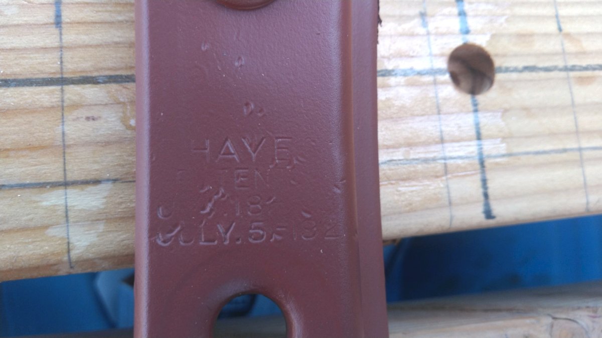

After getting all four Felloes out and apart, I sent them off to sandblast to see what I had. I have two different 'Types' of Felloes..
The First is Two 'No Name' Felloes, with Tennon Holes ranging from .505 to .510
The Second Two are Hayes Felloes July 5 192X.. Can't read the Last Number.. These Tennon Holes range from .515 to .530
I ordered 52 'Hayes' Spokes and got them in and Varnished them, Steel Wool Finish. FOUR Times.. They look good..

Ends up I have TWO kelsey Fellows, and Two Hayes Fellows..
The Rims interchange between the Two Different Mfg.

Cap, the second photo is of a the Kelsey felloe that is supposed to take loose lug rim. That slot pressed into the inside diameter of the felloe is the land on which the longer leg of the loose lug engages. The depression in the outside of the outer edge of the felloe is not supposed to be there. It has been caused by the incorrect fitting of a Hayes fixed lug rim. The 'foot' on the Hayes lug has been forced over the felloe, and likely the rim has stood off the face of the felloe rather more than it should have. For such a combination to work, you would be heavily relying on the four lug bolts retaining tension. The rim will have no contact with the felloe other than at the jammed feet .
In a correct set-up, the Kelsey loose lug rim wedges onto the outer land on the felloe all the way around the wheel. All the four lug bolts do is hold that wedging effect.
Likewise, on a Hayes felloe, the rim is designed to wedge on the inner land on the felloe, the four lug bolts just maintaining the wedging effect.
It is this wedging effect which transmits the drive from wheel to rim/tyre. It is this wedging effect that is compromised by the incorrect mixture of incompatible parts. Sure, they will 'work', in some circumstances, but in others they can be dangerous. Mixing loose lug rims/fellos and fixed lug rims on the same wheel is one of these circumstances.
