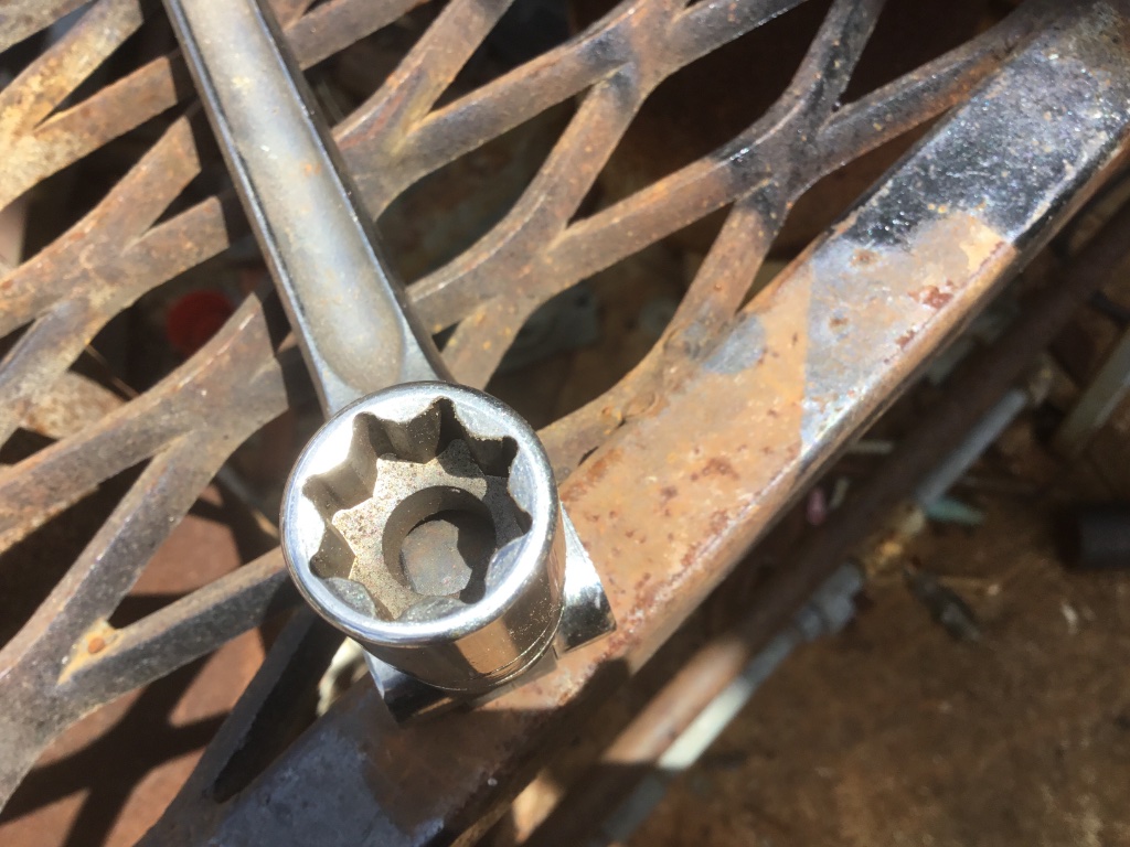

by BobShirleyAtlantaTx
. This is a Snap-on, probably easy to find on line or in your area.

by TFan
Here you go, the socket is a Wright 4fs18 and the wrench is a Mossberg 622 more than likely a copy of a Ford tool. Jim
