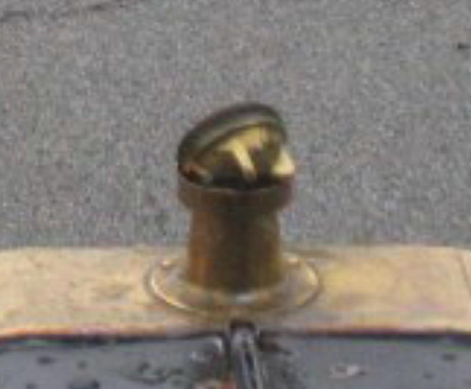

Frank, when you tighten down the cap with the rubber gasket, can you feel it "snug" down on the gasket nice and tight? I have used one of those rubber gaskets from Lang's for years with my dogbone cap with MotoMeter on our '25 coupe and on the TT that Dallas now has with absolutely no problems. Granted, that's not the same neck as yours, but I don't see how your cap could loosen that easily if it is contacting the rubber nice and snug. As was said, an extra 'O' Ring might be worth a try. I did have the MotoMeter nut loosen up once, but I caught it before it fell into the radiator. Dave
Re: Radiator cap spinning while driving.
Posted: Mon Jul 19, 2021 12:50 pm
by kelly mt
I've lost two Motometers now so I don't run them anymore. The cap, Motometer and neck all left on their own. Running dirt roads just makes it happen faster. The replacement pictured worked well, no vibration.
