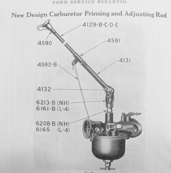

If you are replacing that 'garage built' combo needle, with the new set from Lang's shown in my prior post (6213B)......you will also need the later lock or clamp nut. It has the tall cylinder that the upper split collar fits upon. You tighten the split collar just a bit to get resistance when you adjust the needle. Otherwise without a good resistance, the needle setting can back out or in and cause rough running down those bumpy roads!
