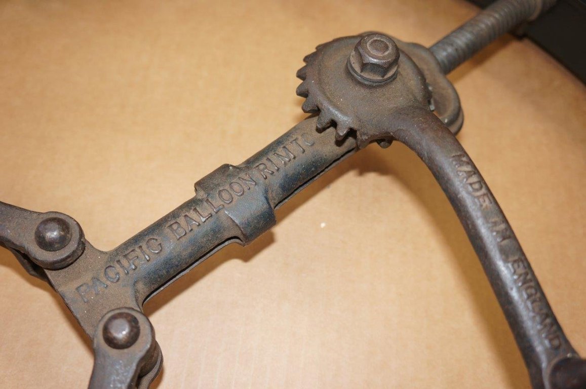

by John E. Guitar
Re: Is this a split rim
Posted: Fri Aug 06, 2021 11:07 am
by Charlie_26_TT_Ccab
Hello there John, thanks for sharing your photos, once again it’s true a picture is worth a thousand words.
