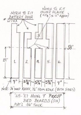

I couldn't find this by searching the old forum. Can someone please share the dimensions of the wood for the pickup bed on a 26 roadster pickup?

Sketch did some years ago from original bed wood.
26 Pickup bed wood dimensions.jpg (34.81 KiB) Viewed 7610 times

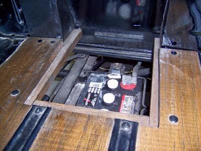

Does anyone have pictures to show how the battery cover fits? I have a replacement cover that a bit too wide to fit the indent in the headboard. I intend to trim about 1/4" off of each side of the cover where it is too wide. My question is, what holds that cover in place? Does anyone have any pictures?

If the runabout rear deck metal is gone, then easy to add channel iron for holding the battery door, or wood pieces mounted under the bed board opening, fit the wood flush with the underside of the 3/4" thick boards, and the battery door lid will fit flush with the topside.
bed battery opening.jpg (49.61 KiB) Viewed 7415 times

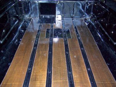

Finished look with battery door lid and hump plate installed.
Finished bed w wood long view web.jpg (50.32 KiB) Viewed 7415 times
