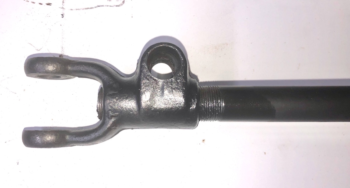

Posted earlier :All the new paint needs to be removed from that tie rod ...end
This is what a clean adjustable end should look like for moving the yoke in and out.
