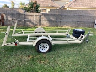

More what I was thinking

Since you'll only have 1 axle & two wheels, don't try for weight reduction and minimal design there! I have a lightweight trailer, like the one you pictured above, but the axle is from a trailer home and it uses 15", 12 ply rated, 120 psi, heavy equipment hauling tires. I've worn them out, but I've never had "tire trouble", (fingers crossed...).

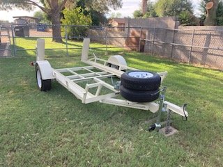

I lucked out and picked this one up from a club member. Has a torsion axle, is low & towes like a dream wich is much better than my 18' two axle dove tail. and its over a 1,000# lighter.
