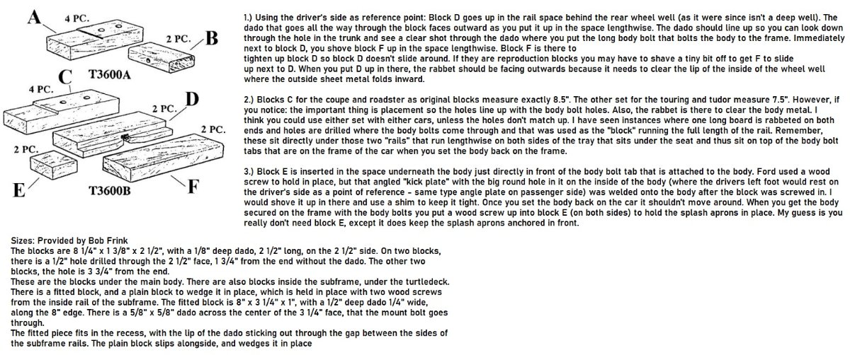

Here is some additional information.
This info below is from this link http://www.antiqueautoranch.com/montana ... yBlock.htm
Re: Timber mounts
Posted: Mon Aug 16, 2021 2:46 am
by Myxr6turbo
These pictures are perfect. So the Block "C" I have and just installed them. There is already a small block wedged in the front "cowl/foot well". I dont have the "D, B, F, E" blocks so and dimensions on those would be great and also where they go. The "T-1107" block I have but no idea where it goes. If anyone has photos that could help that would be great.

Shawn
Read the copy in the lower left of the picture of the body wood blocks, gives dimensions of each block.
That T 1107 is the block under the front edge of the hood shelf, note angle on end of shelf. Left and rights to match the angle.
The smaller block goes under the cowl end of the hood shelf. Provides correct rise of the shelf to hood and angled holes for the hood clips to function.

I just found the covers. I'll make those timbers. So, the only ones I don't have are "D" and I don't know where they go. Do I need them on the Coupe? Has anyone got a photo of where they go?
Re: Timber mounts
Posted: Mon Aug 16, 2021 9:46 pm
by DanTreace
Don't have a clear photo, but D and F are a sandwich that goes up into the subframe rail. Provides support for the longer bolt that goes from the turtle deck into the frame. Enlarge the link given and the captions provide more info on placing D.
Here's a runabout with original blocks, but doesn't show the rear blocks that go deep into the frame rail channel.
