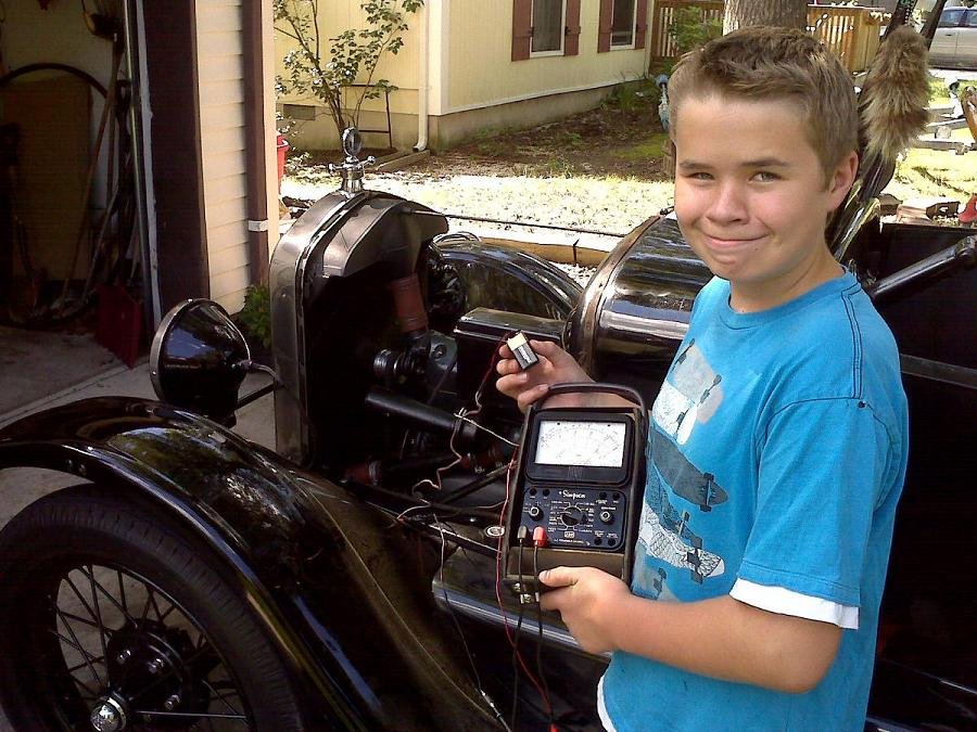

To check the voltage output of the magneto I can use a standard measuring instrument ?
Where to attach minus and plus while measuring if there is a constant Voltage at a certain engine speed ?

test your magneto per this procedure: http://www.mtfca.com/discus/messages/70 ... 760271.pdf
RPM (estimated) vs Voltage (good magneto) can be found here: viewtopic.php?t=11870
