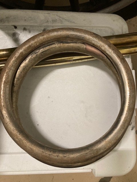

Odd assembly questions:
I am told that there is brass underneath the nickel and the nickel can be removed with a wire wheel? Is that true? won't that damage the brass underneath?

On the headlight rims, I have always been concerned with putting plating on; not taking it off, but I would be very leery of using a wire wheel or brush on brass to remove plating. Even if using a very fine wire size, I would worry that it would scratch the brass. If you have a cotton buffing wheel on your bench grinder, you might be successful buffing the plating off with jeweler's rouge, but the easiest way would be to take them to a plating shop and let them remove the plating by electrolysis.

A plating shop can take the nickel off with no damage to the brass underneath. Otherwise I would suggest wet rubbing paper and lots of elbow grease. As you get back to the brass, switch to a finer grade of paper to reduce any scratching in the brass. The finer the finish the easier to polish the brass later. Any machine use is fraught with danger, both to the operator and the parts being polished. My thumb tells me so.

Re the Nickel - NO please don't try a wire wheel, it will destroy the brass. A YOUTUBE search will give you suggestions to remove the nickel yourself using chemical process. You can sand it off as Alan suggested. Youtube/ Google will show you how to re do the nickel yourself, it is not too hard but does rely on you getting the base as perfect as possible, any wire brush scratch or rough bits or sanding marks - or even just a finger print - will always show through the nickel finish.
