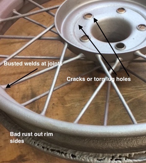

Visual inspection is the better way, unless you have x-ray eyes
Some of the key points: Busted welds at the spoke joints, broken spokes, rim won't roll true on flat surface and wobbles, sure sign of bent wheel.
Look for rust out at the rim sides, and cracks at the hub, esp. the cone shape at the wheel drum area, and between lug holes. Look for flattened rim, sign the wheel was used without a tire, like on a farm wagon, and flattened the rolled edge, that would let a tire come off. Worn out, cracked or oval shape lug holes are also bad news. All the above should be checked before buying or using the Ford welded spoke wire wheel.
