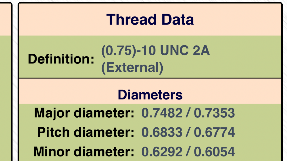

There is a tolerance connected to the major diameter of screw threads.
For a 3/4 10 external thread the max is .750 in.
The minimum diameter is .735 for a class 2 thread..
And .737 for a class 3 thread.
Often you will find that the major diameter is below the minimum, particularly with economy applications.

.730 diameter sounds believable for a 100 year old machine screw thread. Most of these parts were produced when the National thread standards were in their infancy... so not surprised when profiles and dimensions are slightly off our modern standards
