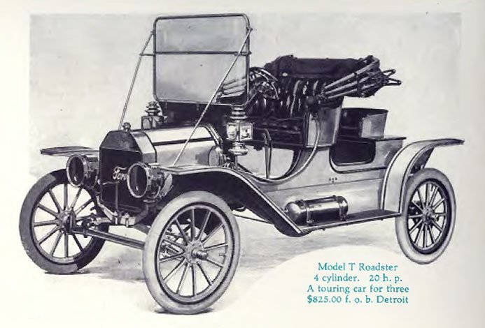

by KWTownsend
I love my Prest-O-Lite tank. No muss no fuss.
If I were to modernize them I would look into the LED (not halogen) bulbs that screw into place of the original burners.
Bob has them. Snyder's has them.

I mounted a small motorcycle prestolite bottle along the frame rail. It's not visible and while you have to get down and under to open it it's no harder to turn on than checking the oil. If you go that route you need to find a prestolite bottle with an offset valve and install it with with the valve at the highest point. Some people put them under the rear seat but I have never been comfortable with acetylene in a confined space. Modern bottles have a centered valve and are designed to sit up straight so they are not supposed to lay on their side. Before I found a bottle with an offset valve I made a bracket to mount a modern bottle on an angle so the valve was effectively offset.

An additional upside to the Prestolite tank is that it was a Ford authorized accessory. Even some of Ford's sales literature showed pictures of early model Ts with Prestolite tanks.
