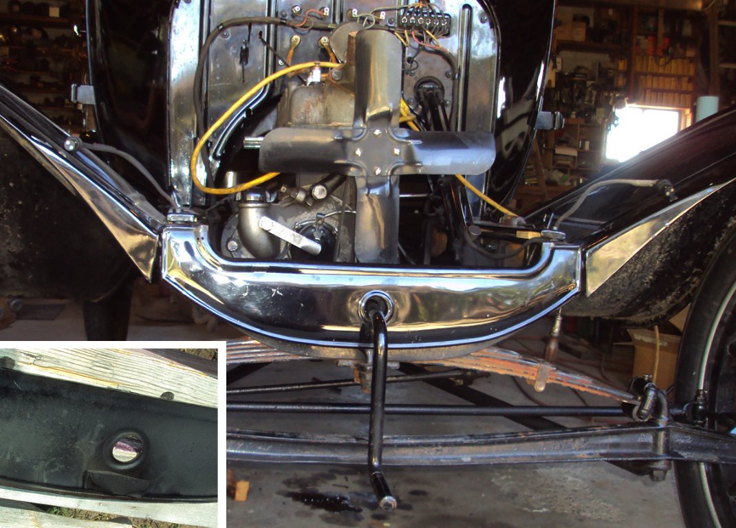

The improved Fords '26-'27 and the nearly improved Fords '23-'24-'25 were adorned with the bedazzling and staggeringly beautiful Radiator Apron part # 3977. Along with the added flair of the fenders and some other minor additions this made the old, ugly Model T Ford beautiful enough to out shine other competitors and save falling sales. Often we tend to take these parts for granted but today I am thinking of this one.
My first observation this week was how it hid the timer from view or access at one angle. I could have readily seen a loose wire had it not been there.
Secondly, it should be removed or notched (use your best judgement) to remove the engine and still have the crank in place for guiding the front. Mine is held in place with a fender bracket bolt on each side going through it. The radiator mounting bolts also go through it. I had removed the latter and will not air my grievances on them at this point. All three fender brackets have to be removed or at least loosened on each side to free the apron. While the bolts were all new at assembly 20 years ago, they and their cotter pins have rusted securely in place. Getting my head and two hands as well as the necessary wrenches and pliers has become more of a contortion challenge than I remember.
Never the less, after 3 hours I have it safe and sound on the bench. Shown at lower left is the apron with a rubber pad I glued on it to stop an illusive rattle.
