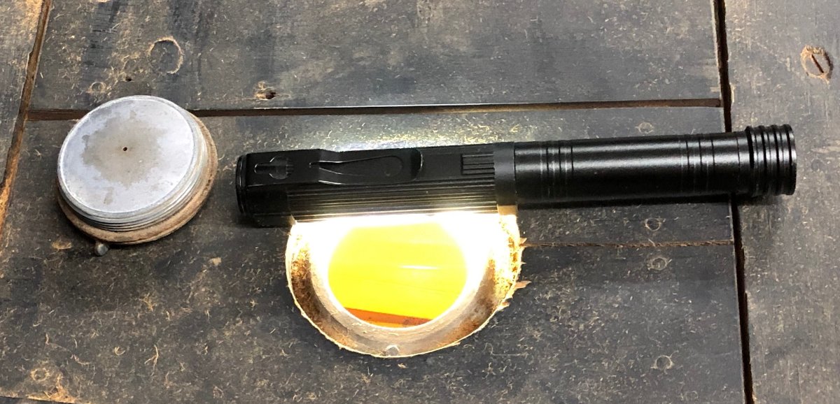

When I bought my '14 project the tank had been drained and the car stored for some time. I looked in the tank and it looked pretty good. After getting it running & driving, the NH started minor flooding. I could smell raw gas while driving and the motor felt like it was "fluffing" at low speeds. A newly rebuilt NH was installed and it did the same thing. A look inside the fuel tank showed that the situation had changed:
Now the tank I thought was clean had all sorts of rust bits inside. Something had to be done so I advertised for a new tank in the PARTS section of this list. I wanted a new tank so that I could install it in the car and have a minimum of down time. A fellow had a new tank setting on the shelf and we struck a deal to have it shipped to me.

The tank was indeed new but had been sitting for some time sealed with blue masking tape. The neck threads were rusty and the baffle showed rusty spots where it had been welded. Only a small portion of the inside can be seen and it seemed likely there was more rusty spots that were not visible.
The ever helpful Scott Conger suggested the POR Fuel Tank Kit. He also provided some tips that helped fil in areas where the kit instructions were somewhat breezy. I ordered the kit and following Scott's advice bought a 2" test plug to seal the fuel tank filler hole and a 1/@ plastic pipe plug to seal the area where the fuel bulb screws in.
The rusty threads in the neck were cleaned with a wire wheel mounted in a Dremel.
After installing these plugs the cleaning solution was poured in and diluted with water per instructions. This was followed by lots of rolling & agitation including swapping end for end. The cleaning solution was left in 24 hours then drained. I have saved it to see if it will clean rusty tools. A lot of time was spent rinsing the tank to make sure it was all out.
Next the etch was poured in and rolled around & agitated the same as the cleaner was. The leakage was powerful enough to mark the outside of the tank in just the few minutes in took me to clean it up so I judged it would need less time than the cleaning step had. I left it in for the afternoon then drained & rinsed it out three times to make sure it was all gone. The tank was sitting out in the sun on sawhorses and a hot air gun set to low blower was inserted into the filler neck. This was left in for 2 hours. The tank became too hot to touch & a rag was used to protect the sawhorse.
