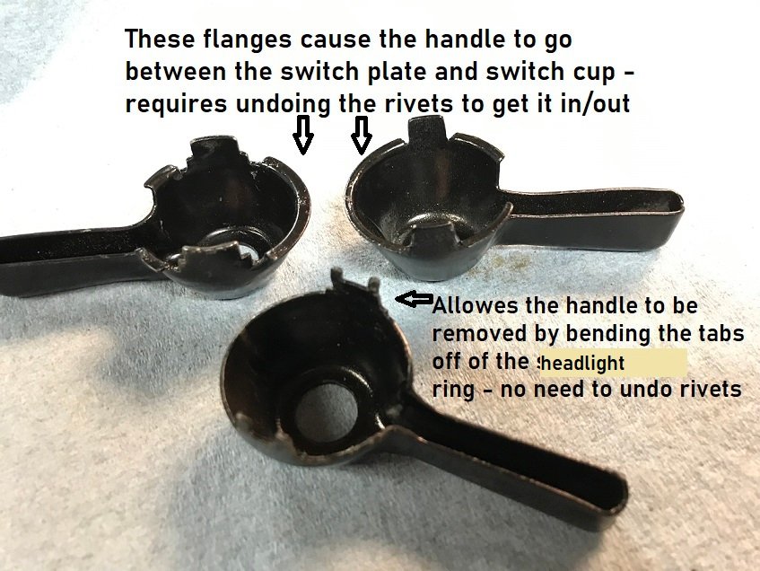

Pin or Clip type backing plates have the same internal parts regardless of shape (oval or rectangular pate with 2 rivets holding the Cup). Note: There are some exception in rectangular. The original internals are compressed paper and the pin type are a bit thicker. Depending on the problem you might just need a backing plate. These things are really easy to fix. A new tumbler is the more difficult. Send me an Email and we can discuss further - I'll be glad to help you through it. Will need some pictures to see the inside.
There is one other internal piece that is the same for both styles pin or clip. However there is a difference in the way it attaches to the square internal part in the first picture. This difference is also repeated on the switch handle. You can see there are prongs on one while the other has flats. Don't worry bout this difference.
The internal parts provide a spring like effect on the backing plate. So for the PIN type the easiest way to remove it is to a straight edge across some screws to act like a handle while pushing down and rotating counter clockwise.
Do not try to bend the the metal contacts shown in the above pictures - just clean them.
If the backing plate is warped you need a new one. If not, rub it across some fine sandpaper to freshen it up
Do not remove the small ring holding the tumbler (that's when you need to email me)
