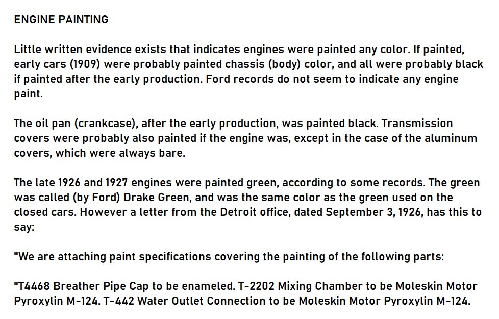

This indicates that 1926 engines ere painted Drake Green and some parts were paint Moleskin
http://mtfca.com/encyclo/E.htm#eng5
Then this says for 1927 a mix of colors to dress up the engine.
http://mtfca.com/encyclo/P-R.htm#paint3
Might have SW try these to see what the colors are
Don't be concerned with the name "Moleskin Brown"
from http://www.texastparts.com/mm5/manuals/ ... Colors.pdf
