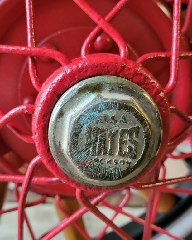

				Keith, the hub cap I have looks like a normal FORD one except it says HAYES on it? Is that correct or are the hubcaps like the 26-7 design with the tabs on the back? Just asking before I ship it to you?
Joe
				Re: Hayes wire wheel questions
				Posted: Wed Nov 10, 2021 6:28 pm
				by Kevin Pharis
				The correct caps have external threads.  The repops were cast brass, not sure about the originals...
				Posted: Wed Nov 10, 2021 6:45 pm
				by KWTownsend
				Joe-
This is what the hubcap looks like:
Kevin-
The "flat" brake surface width looks to be about 1-3/16" then the arc of the corner starts.
Keith
				Posted: Wed Nov 10, 2021 7:52 pm
				by Joe Bell
				Keith, that is not what I have, Sorry!
