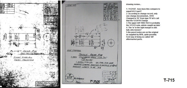

Last time that I looked, there were two different pin vendors and both were definately serviceable, yet one was just a degree more precision out of the box. It's been a while tho and you can maybe do a search...I think the one was center-less ground, the other ground on centers like originals but I can't recall which one was the 'tighter' of the two.
Do mic them when you get them...I'm also told there are oversize pins somewhere in circulation that should be labelled as T715AR but may not be. The fat end tells you which is which.
FWIW, if you do decide to do things yourself...really do search as the final clearance for a home done job CAN NOT be what is purported to be the designed clearance. You hone them to that number and you may just get 100 miles out of the rebuild

with respect to triple gear bushings, you can find a lot of disagreement on what the drawing means for those bushings. It's an interesting read if you research it, but if you chose the wrong fellow to listen to, you will get much practice rebuilding your new transmission. Over and over.
Read this regarding our Tech Editor's sad tale and resulting information presented...and note the Ford Factory finished clearances derived from both the reamed and broached method of bushing sizing: http://www.mtfca.com/discus/messages/179374/210880.html
A careful read will further reinforce John's advice

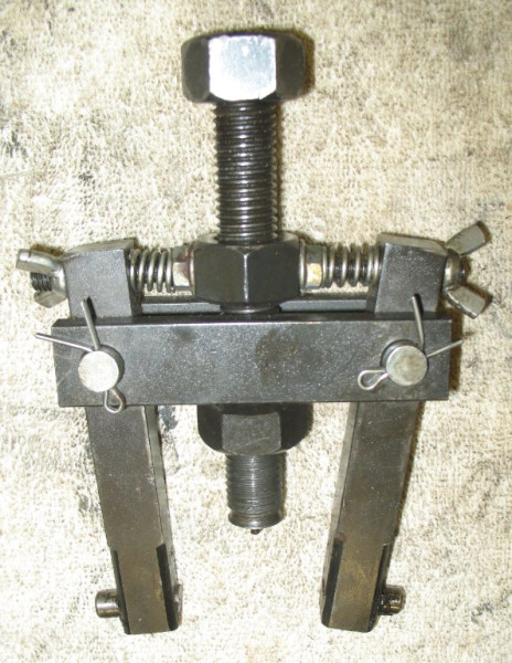

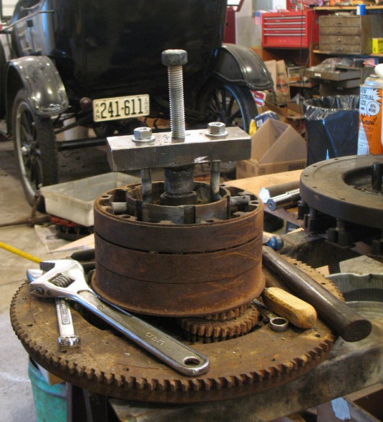

The original Ford clutch drum puller sometimes works, but a particularly stubborn drum will just bend it.
I agree the puller sold by the parts dealers is much better.
You can also make your own if you have a heavy enough chunk of steel.

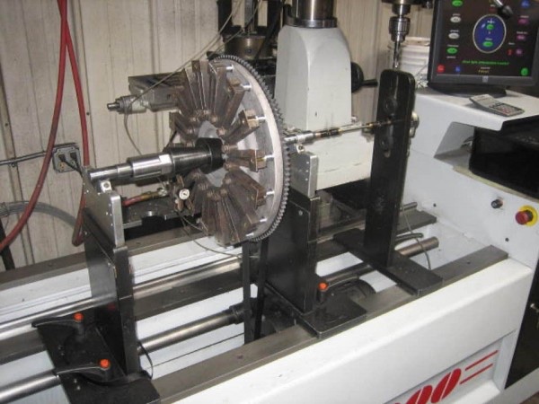

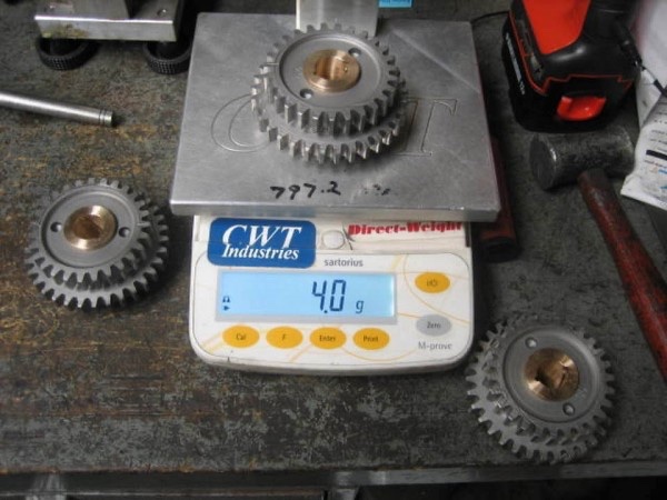

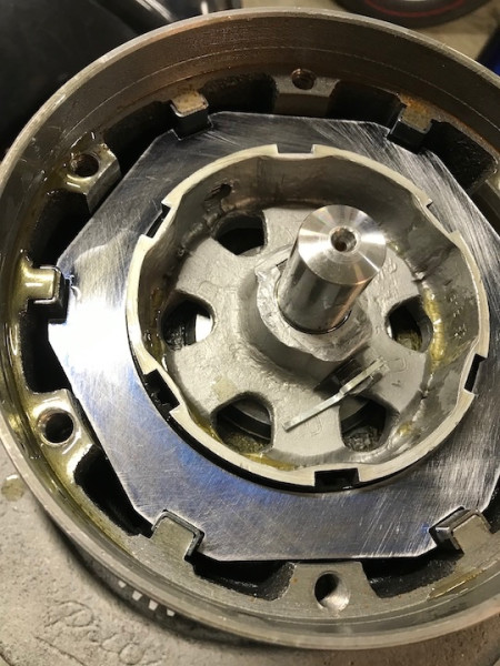

OK here is my 2 cents. I just went down this road You can see what I've done here
viewtopic.php?f=2&t=9508
My Transmission broke a triple gear pin and ended up causing all kinds of issues. The Model T is a very forgiving car until it's not. You can read all about people bandaging their car together using all sorts of trickery. Some good some bad. For me rebuilding the transmission was beyond what I was capable of.
I started researching machine shops and found J&M Machine in MA. When I brought them the transmission John took it apart and magnafluxed the drums. Two of them were cracked. The third was put on a lath so many times that it was extremely thin. So I needed new drums. Not many people make them but J&M does. Comparing their drums to the originals I could see that the J&M ones were very strong. Keep in mind that when using 100 year old parts most things will be worn out. I also got to see what a good machine shop looked like while I was there. I chose to use their drums and their services as I didn't want to do this job again.
They balanced everything and made sure that I would all work perfectly.
Balence machine.jpeg (88.83 KiB) Viewed 4353 times
gear weight.jpeg (87.36 KiB) Viewed 4353 times
So were they a bit more money. Sure. Did I make an investment in my transmission so I won't have future problems. Yes!!
Remember Machine work is expensive. Bad machine work is way more expensive.

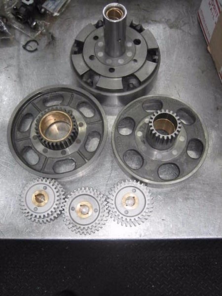

Hey I’ve read thru the rattles thread. Good stuff 👍 love the planetary pack pictures. Looks like you have done some reading. I look forward to doing mine no matter what I find. Just “looking” at the trans internals they appear solid/clean/nice color/smooth drums/got all her teeth. The triple gears feel a little wobbly thou. It’s a 26 Tudor if I didn’t mention it. I have a Fresh short block so the trans is next on the list so I can stay true to the fourth main and heck why not? I love playing with this thing. In the end I will take everything apart😃

Just a word to the wise once again...IGNORE the Ford specification of 0.002" 'clearance'. Ignore the Ford caution 'worn out at 0.005"'.
You need to shoot for 0.0035 total between the pin and live with size to 'over' in the 4th decimal place. Cleanliness is next to godliness. Cleanliness is next to godliness. Cleanliness is next to godliness. Make sure to face the bushes to 010" and not leave as stock. Make sure you insert and seat the pins from the right side. Make sure the oil grove in the bush is full and not just a scratch in the bronze.
All of this is in the book, but make yourself post-its...its not just 'only a T'. Done right and driven right that 0035" will take your lifetime and then some to grow past 0.005". Done too tight or to original Ford specs...and those who warn know...your chances of swallowing the rebuild in early mileage go astronomical.
If your friend would like to know design 'maximum material condition' and 'minimal material condition' range charts made from Ford original drawings...drop me a note...most folks don't understand them so I won't confuse here, but if your friend is that saavy...I'm here.
