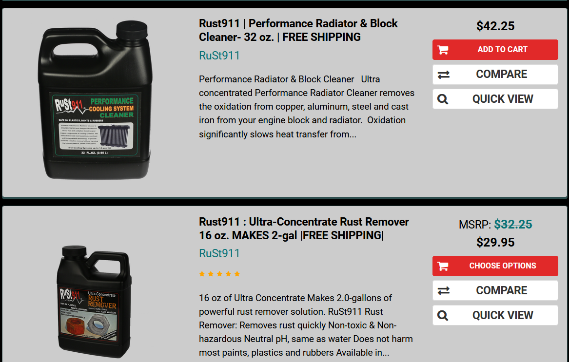

The rust color changes indicate its a concentrated phosphate based product .
Information on toxicological effects Phosphonic Acid, Salt LD50 Oral Rat / Male/Female 1,512 mg/kg -
Always good to know what works for a specific problem.
https://www.rust911.com/rust911-home-page/
https://www.cnet.com/roadshow/news/best-rust-remover/
