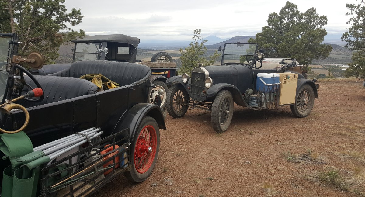

by Dennis Prince
A friend went with the Lucus 525/21 tires and they are about 1/2 in shorter than the Firestones and he didn't get very good wear out of them. I average about 35,000 to 40,000 miles out of a set of Firestones and there is still some tread left and I tend to torture my tires more than most.
