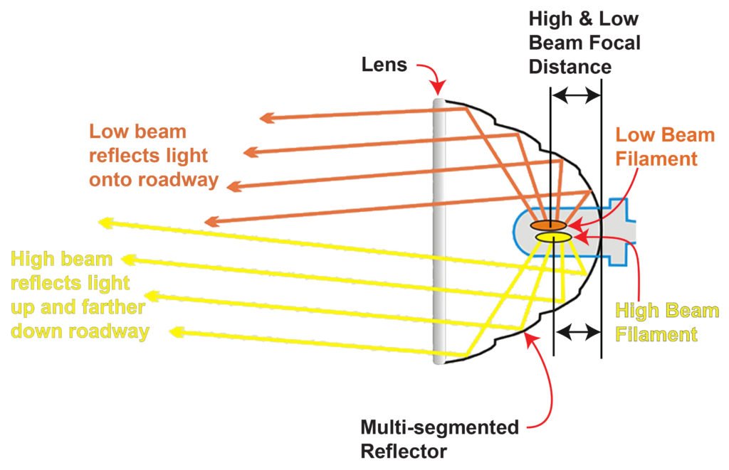

NOW the issue with headlight bulbs is that there is a difference between looking at a brighter headlight versus looking a a brighter road ahead. The reflector in the headlight has a specific focal point where the light source needs to emerge from to optimally project the light. Light outside that focal point is unfocused & dispersed broadly
Here are some diagrams to help visualize how things work
The job of the lens is to direct the light in a specific direction.

The word "pin-point" in the context of a reflector depends on the design of the reflector. Its like a magnifying lens - things can be "in focus" within a small range, anything outside that appears as blurred and unfocused yet it can be seen . So LED bulbs make the lens brighter but not necessarily projecting a concentrated beam of light forward. Again, the lens partners with the reflector to projects the available light forward. One of the reasons the plain flat glass lens was changed to a fluted design on Model T's

Frank, I wonder where that image in your 8:45 post came from? It looks to be comparing LED tail-light/indicator 'bulbs' to a later incandescent bulb with regard to headlamp focal points?
I'm not sure it's the best comparison; FWIW the LED's I use are specifically for headlamps and do not have the additional light throw that would likely result from LED's such as those depicted (which clearly have quite a broad light source).
The diagram was my own making to help explain the meaning of pin-point. There are many designs of LED 1156/1157 replacements. 1156/1157 bulbs are indicator bulbs, BA15 (horizontal pins) and BAY15 (off-set pins) bases respectively. 1156 is a single action running/turn signal while the 1157 is dual action running/turn signal & brake light. The suffix applied to the base indicates the internal contacts S for single or D for double. Now the headlight filament bulbs that the vendors sell are actually 1188 bulbs 50/32 candle power. Note that the reflector is what magnifies the CP of the bulb to a 50CP bulb may project 20,000 CP and it is the lens that aims the light. Again a very bright lens doesn't mean that the light is focused, in fact if viewed from different angles the amount of difference indicates what is actually being aimed.
