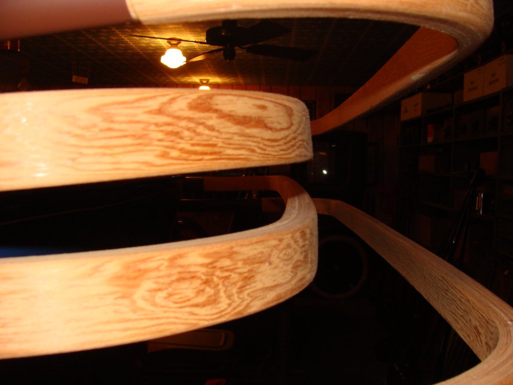

The important part is the bow alignment.
Here is my car:
Here are the dimensions I used:
These measurements are in a straight line, from the center of the pivot points to the ends
Unlike later cars, bows #2 and #3 are about the same height.
When the bows are down, #1 and #4 should match up and #2 and #3 should match up.

All these measurements is very tedious work. When you get frustrated, take a break. Have a friend help you hold parts together as you measure.
C-Clamps, ratchet straps, and lath are your friends.
Keith
