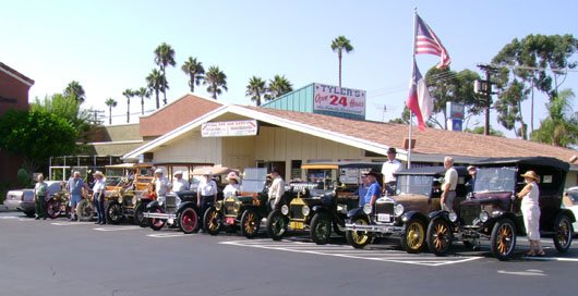

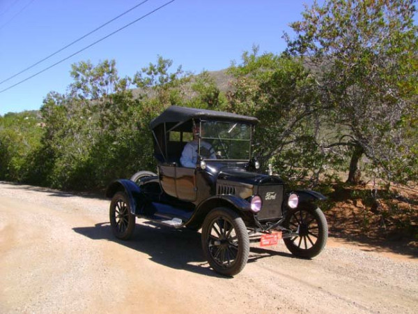

1922 seems to have been a year of transition from the two man top to the one man top. The windshield also changed and the radiator changed from the low radiator to high radiator. So It is quite possible that some of the plants used up their existing parts before making the change, so there were both styles being sold at the same time. And some states dated their model year from the year it was first sold so toward the end of the year there would have been some of the next year models being sold and some of the last year styles being sold. I know a friend who has what he calls a 22 and it has the later type top and windshield. My 22 roadster has a low radiator, a steel firewall and a 2 man top.
- my 22 Runabout
My friends 22 touring on right. Notice he has extended the windshield posts because he is quite tall.
- My friend's on right
