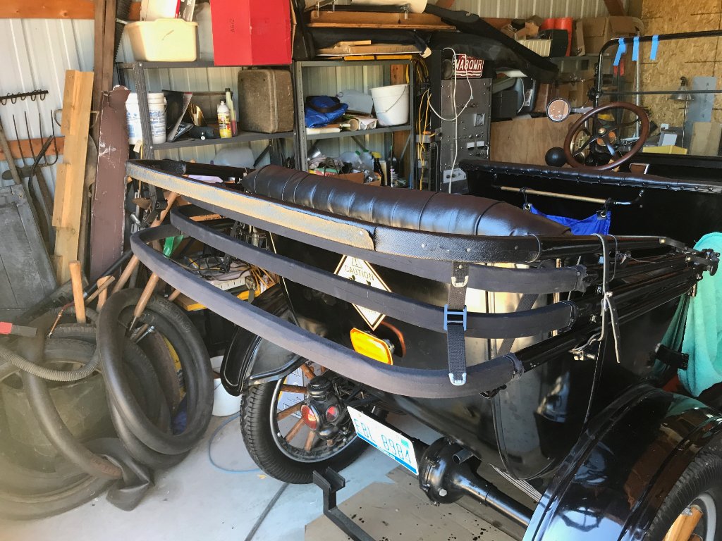

Nice job Mark! My '17 bows were a little more of a challenge because the wood bows are steam bent, not straight pieces like the later cars. Brian, if you buy a used set of sockets you'll likely want to dig out the rotten wood inserts and replace them with poured-in resin. I think the new ones come that way. Jonathan Anderson made my bows and did an excellent job. He marked each one showing how deep they needed to be inserted in the sockets leaving it to me to shave them to fit. A spoke shaver and a good sander does the job.
My wife sewed the fabric for the three rear bows into a tube which made it pretty easy to put it on. I sprinkled the fabric with water then used a hair dryer to shrink it. You can see the results.
