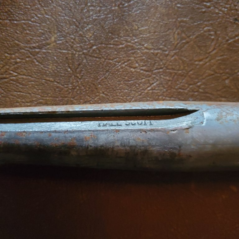

Perfectos were originally sold with one axle ground the entire length. I have an original. It's stamped with the name Hall Scott in the keyway.

Axle keyway.
