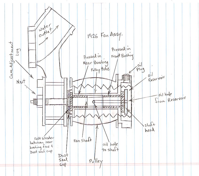

Sean, Ford used oil in the fan. The threaded hole on the fan is for the filler plug, many replace it with a zerk fitting and use grease. Both oil and grease work out of the rear of the fan shaft and make a mess on the inside of the hood. The felt washer is the seal, essential when using oil, but it slows down the grease leaking out too.

I like moly grease, especially for chassis lubrication, but it might not be best for a brass bushing, since it has sulphur or sulphide in it. (MO2S (?) I'd use red grease and a felt seal. The best solution is the ball bearing hub.
- Posts: 5545
Re: Fan reassembly
Stick with oil. Grease just does stick around between the shaft and brass bushings. Some use motor oil, me and others, a heavier lube like 600w or even chainsaw bar lube. I tried grease, my fan let me know it did not like it!
- Posts: 8649
Re: Fan reassembly
Ford used oil lubed fan hubs up to about 1950.

My hub has a "t-handled" plug in the fill hole with a spring loaded ball for adding lube without removal. I put grease back in because it was what I took out. Though this could just be oil drying out after 20+ years of sitting. I will go with changing out to a heavy weight oil if that's the way Henry wanted it.
- Posts: 5545
Re: Fan reassembly
Larry brings up the early style using grease because that is part of the discussion about what lube to use RE people using grease instead of oil in the later style fan hubs.
- Posts: 2067
- First Name: Jeff
- Last Name: Humble
- Location: Charlevoix, Mi
- Board Member Since: 2006
Re: Fan reassembly
Sean, that T shaped ballbearing plug is an early grease gun fitting. Unscrew that and replace it with a oil fill plug available from the usual vendors.

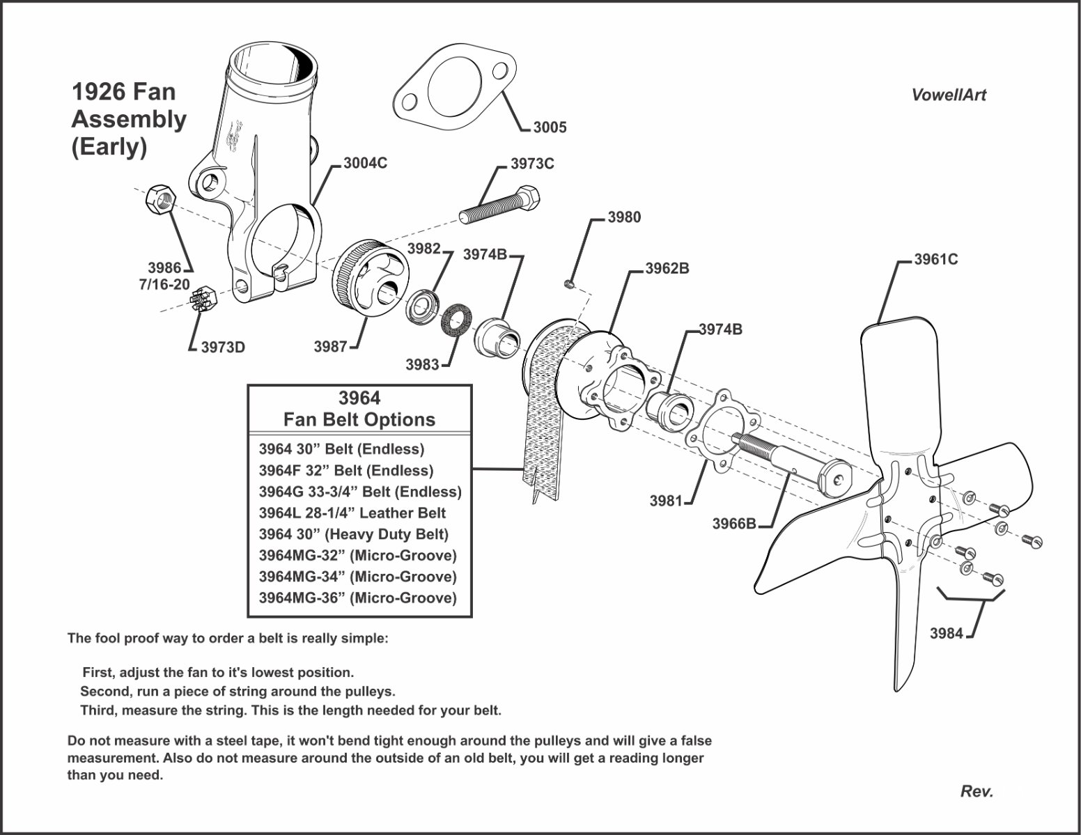

Hi.
Bringing this thread back up again because right now I am trying to reassemble my early '26 fan hub (the one with the clamping bolt on the underside, short version).
I changed the fan blades and seal, cleaned everything up and try to get it back together like in the sketch above with felt seal and dustcap.
But something does not work. Whenever I tighten the nut the shaft does not move anymore in its bushings. The dustcap with the felt seal is pressed against the eccentric and the rear bushing.
The eccentric's hole (where the shaft goes through) looks like that there maybe has been a thread in it - but my shaft runs straight through without screwing.
Should there be a thread for the shaft in the eccentric? This would explain the problem. With a thread the shaft could be screwed into the eccentric until correct belt alignment and the locked with the nut.
Does anybody have picture of correct assembly?

The eccentric is not threaded for the fan shaft.
The drawing above is correct.
Note that the fan shaft sticks out further than the pulley end bushing. That provides the space for the felt washer.
The felt retaining washer fits tight to the eccentric & fan shaft, locking the shaft.
The bushings could be to thick in the flange or the fan shaft is not correct.

Strange.
Found an assembly picture here: https://mtfca.com/phpBB3/download/file. ... &mode=view
But for me it's same problem.
If I tighten the nut (3986) hard enough that it doesn't come off I press 3987+3982+3983 against 3974B.
In the end it can't turn anymore. What's the trick here?

Sean: Are both bushings fully seated in the pully? (Bushing flange undersides tight against both ends of pulley) If so, you need to remove some flange material from one or both hub bushings. Part number 3974B in this assembly drawing:
app.php/gallery/image/1124
Does the fan axle support, p/n 3988 fit squarely against the 'step' in the fan axle? If the hole is wallowed out the shaft may be drawn into the washer and that may also cause the symptoms you describe. All the best, jb

Even more weird: In all those 26/27-images the shaft is declared as 3966B, but in the shops the shaft with the recession for the wrench at the end is 3966C.
The early 26 does not have that support plate. There the dustcap seems to fit against the 'step'. But as it seems for me there's not enough space for the felt washer between bushing and dustcap. It is squeezed way to much. Maybe I will try a washer to make the thicker part of the shaft a bit longer.

Check that the front bushing is not binding on the radius between the bolt shaft and head. You may need to chamfer the bushing hole somewhat.

Here is the instruction of the 1st style or early '26 fan with the worm like drive eccentric using a special bolt from the Service Bulletins to help.
Have only experience with the later '26 fan and easy wrench adj. smooth eccentric.

Good idea - I will check that. Also if the bushings are pressed in completely. Else the washer solution will be used.
Thanks to all.

Good practice when installing any flanged bronze bushing is to stop pressing shortly before the bush is home, and blow out ant swarf which may/may not have formed around the bush. Then press it home.

One things for sure. That assembly is the one thing that spews oil/ grease everywhere under the hood.
- Posts: 8649
Re: Fan reassembly
My late-style fan doesn't leak much oil, if any. I'm not sure why. (I don't fill it completely full of oil) Like most all old cars without positive crankcase ventilation, over miles of driving, the oil mist from the filler cap and throttle rod openings accumulates on underhood areas as a light film. If you drive on dirt roads, the film will attract dust. Most Ts leak some oil at the crankshaft, and during open road driving, some of this can find its way to under hood surfaces. I find that gnats and general bug splash are as much of a nuisance as the the slight amount of oil that gets on the underhood area.That problem is not limited to Model Ts.
