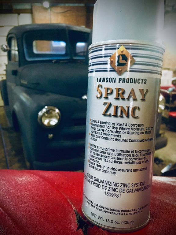

Has anyone used the cold galvanizing zinc 'paint' on rims? And if so how does it hold up? And fwiw, this is hardly off topic. Thanks, jb
Re: OT - Better quality rattle can paint?
Posted: Sun Jan 09, 2022 11:20 am
by kevinf
James, Yep I have used the Rustoleum brand cold galvanizing spray on a set of 21" rims. It worked great, dries very flat, but has a good look of bare galvanizing although without the "pattern" that sometime galvanizing has. I did it on a car that belongs to the local historical farm and so far it has held up very well, I think for about 4-5 years.
Hope that helps

I used cold galvanizing spray paint on a gas tank and the paint turned to powder that you could wipe off with your hands.
Posted: Tue Jan 11, 2022 7:17 pm
by TXGOAT2
Doesn't sound good, but it may be supposed to do that if it's intended to be an undercoat.
