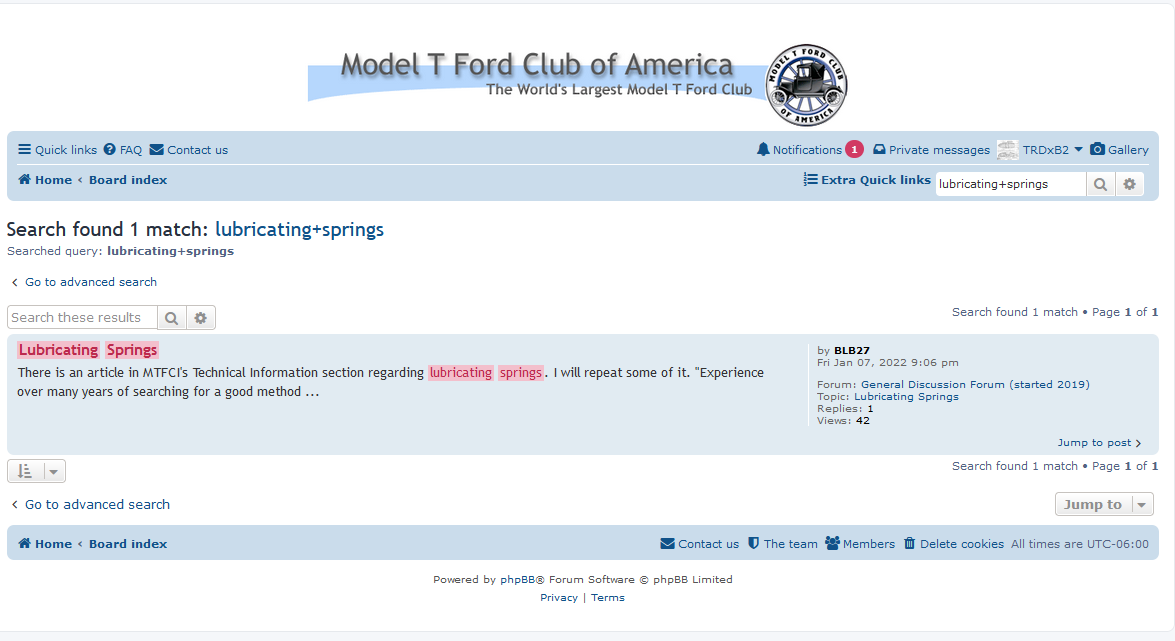

there's more
Searching via MTFCA Advanced Search https://mtfca.com/phpBB3/viewtopic.php? ... gs#p201723
