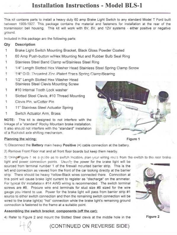

Bob
Here you go. These are instructions.
