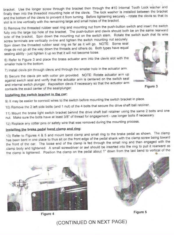

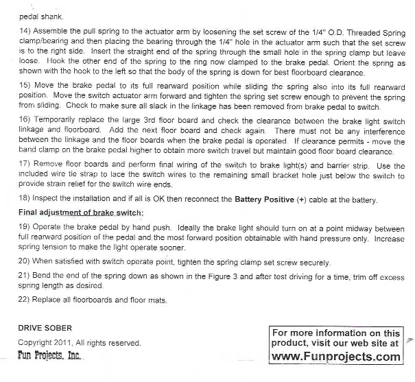

Does anyone have the installation instruction sheet for the Fun Projects Stop Light Switch?
Could you please post or emil me a copy?

Bob
Here you go. These are instructions.
