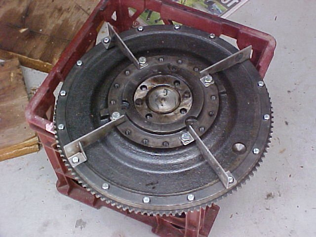

I use distributors all of the time. Use slingers instead of magnets. Slingers pump plenty of oil. I use mag post oil line with mag pin assembly removed. No issues so far with oiling.

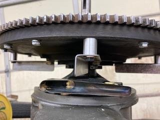

I had to remove a friend's engine just to replace those slingers, after one broke loose for no apparent reason.
- Posts: 5620
- First Name: Henry
- Last Name: Lee
Re: Running Without The Ford Mag
I use nothing but distributors with 8 slingers slightly cut down on width. Some real oil moves!
Hank
Hank
- Posts: 5304
Texas T slingers "had" a reputation for coming apart. Dont know about now, but wouldnt take a chance. I make 4 slingers from T6 90 degree x 3/4" x 1/8" extrusion, full magnet length on spools, Running them in 3 of my own & a dozen or so customers. No issues. Moves a lot of oil.

I believe the Texas T slingers have been updated with a gusset to prevent the failure issue from the older style where they wear bent. I use broke steel or extruded aluminium and make my own spools. Someone told me they had a cast Ford spool crack when tightened down with a grade 8 bolt.

Do not make my own anymore.., cut down the width to break down over loading unnecessary drag, add 8 total for better balance.

Using 8 slingers instead of 4 might reduce horspower loss at higher speeds by causing troughing effect, which would introduce slippage. With 8 slingers, liquid oil would only have 1/2 the time to flow in behind one slinger before the next one came by.

Narrowing the vane will reduce torque and drag. I use an outside oil line as well.
