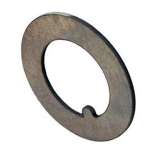

The lock washer has a tab on the inside (hole) of the washer. This slots into the groove on the spindle so the washer cannot spin.
assembly order: bearing / lock washer / castle nut / cotter pin/hub cap.

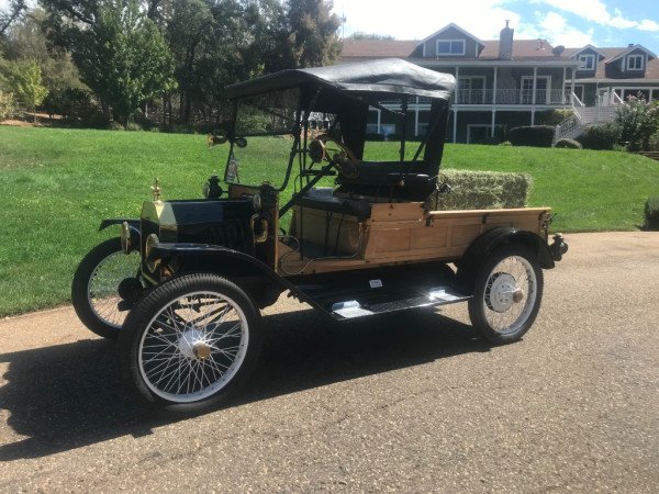

This is his vehicle...
T Truck.jpeg (80.63 KiB) Viewed 12588 times

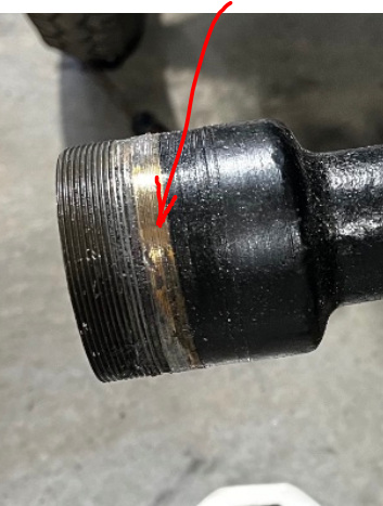

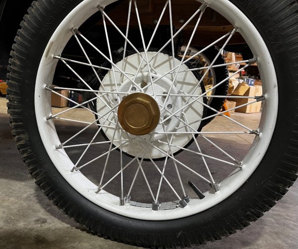

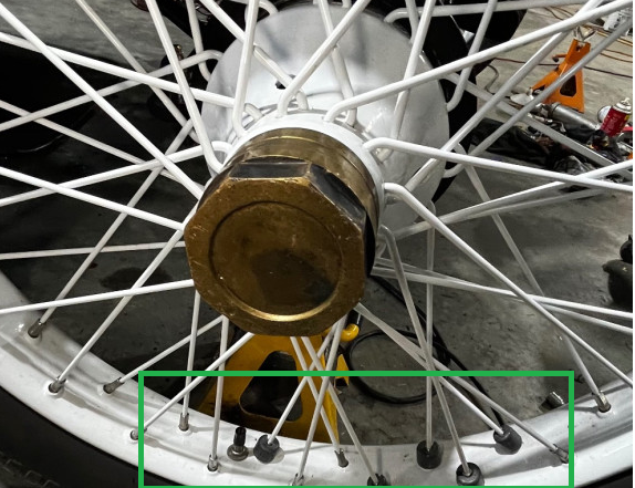

by WillsT
Ok, here are some pictures of hub and wheel separate and once mounted
I have no issue with mounting the hub with two bearings castle nut and cotter pin
Everything stays in place and functions normally
The wheel slides over the hub and and is kept in place with the threaded hub cap/nut
This cap/nut is what comes loose after driving short distance
Re: Left hand thread vs right hand thread on front hubs
Posted: Fri Feb 11, 2022 9:47 pm
by WillsT
Missed picture of hub and castle nut holding it in place
After reading Dan’s. Post and browsing the Jaguar E-type forum where the E uses knock off wire wheels there seems to be agreement that the the hubs with the right hand thread for the hubcap should be on the left, or drivers, side and the hub with the left hand thread should be on the right side.
This is opposite to the way my T came so I will interchange the two and go for another test
Thanks for all the help, you guys are very helpfull

Understand your concern Dan, I will take them apart as soon as I resolve the front hub issue.
Car came with another complete set of artillery type wheels, very nice wood but tires old and worn.
Tires on the wire wheels are very new and little wear, so that why they are currently mounted on car

Is the cup on the inside of the wheel properly engaging the cone on the hub? From the image of the scuffed black paint it appears to me the wheel is sitting on the lip/edge of the hub cone, and should go on another 1/4" or so? I doubt the black paint is the problem. And the hubcap appears to have plenty of thread and end clearance to tighten several more turns, which suggests (to me ) that the wheel is not fully engaging with the cone of the hub?
Beautiful vehicle, especially the wheels, I like the wheel balancing weights on the spokes. Best, jb

As nice as they look from a distance, now that I've seen them close up, I would not drive on them. Dan McE has pointed out and commented on some things which I would have mentioned if he hadn't. The front hubs plain old frighten me.
I think it is a cosmetically nice application with some clever machining done to effect it. Unfortunately there appears to be little if any real design put into it and simply looks hazardous as it is. Worse, I do not see how they could be easily modified to take the forces that are routinely applied to them when driving.
I highly suspect that if these wheels have been on this car for any length of time it is because this car was a trailer-queen. Despite their attractiveness, I personally would not put much time/energy into trying to make these work. Model T's come with plenty of built-in hazards as they stand, without adding a home-made wheel setup into the mix.

To add to others concerns, it scares me to think that the threaded nose on the hubs appear to be a brazed-on addition.
Posted: Sat Feb 12, 2022 11:50 am
by Kevin Pharis
I suspect that this bronze ring is from the hub cap running on the hub surface...

Lookin at the pics again... seems like the spoke ends could be crashing on the hub prior to the wheel seating on the hub fully. This erroneous seating of the wheel would cause the hub cap to tighten, but the hub/spoke heads would deform rapidly causing the assembly to work loose. Check for corresponding wear dimples on the hubs

Note differences in rim shape and valve stems... and spoke weights Front vs Rear (with lead weights) :o
Front
Rear

Is the brass deposit on the inboard part of the hub threads actually brass threads pulled off another hub nut? If so, wouldn't it prevent the nut from tightening properly on the wheel's hub? Do these wheels make odd noises, like pops, squeaks, creaks, or thumps when going down the road?

Took the other front wheel off and you can see a nice clean thread on the hub useable over the whole range of .66 inch, see picture
The hub in issue has some damage because the hub nut was half off which created the bare brass visible
Also the thread on the hub was not useable over the last .16 inch. Due to loose wheel or maybe before will never know
The useable part of the hub is just what is needed to tighten the wheel onto the hub within measurement error.
So did the hub nut stop turning because the thread was limiting or because wheel was tight ?
To remove this question I cleaned up the remaining .16 of the thread and the hub nut now travels the full .66 inch of thread without stopping without wheel in place, so hub nut will now stop when wheel is tight only.
