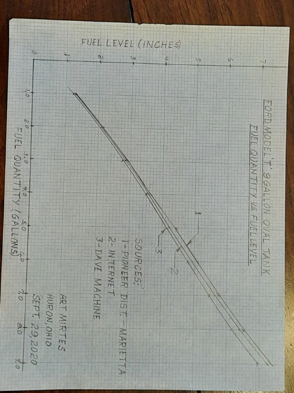

I was interested in the fuel level vs volume. I found 2 calibrated sticks from various vendors and a chart on the internet. These were plotted as shown on the attachment.
Bottom line. I keep the level above half way, because I never know when Tim will lead us to a 8 percent grade.
