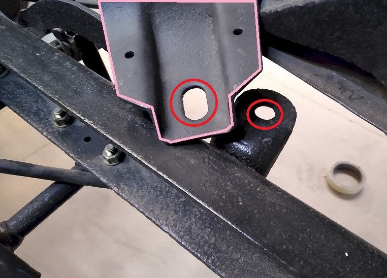

This is where the 1926 Coupe body sub-frame meets the frame on the driver's side.
The front bracket (pink) is not yet installed.
Q: Should there be any gap between the two (red circled) holes once everything is in place?
Thanks.
Re: Body bracket to frame mounting?
Posted: Mon Feb 21, 2022 3:28 am
by varmint
After pouring over images I found one from Bruce Brakke that shows the answer.
The other body mounts all have blocks of wood.
