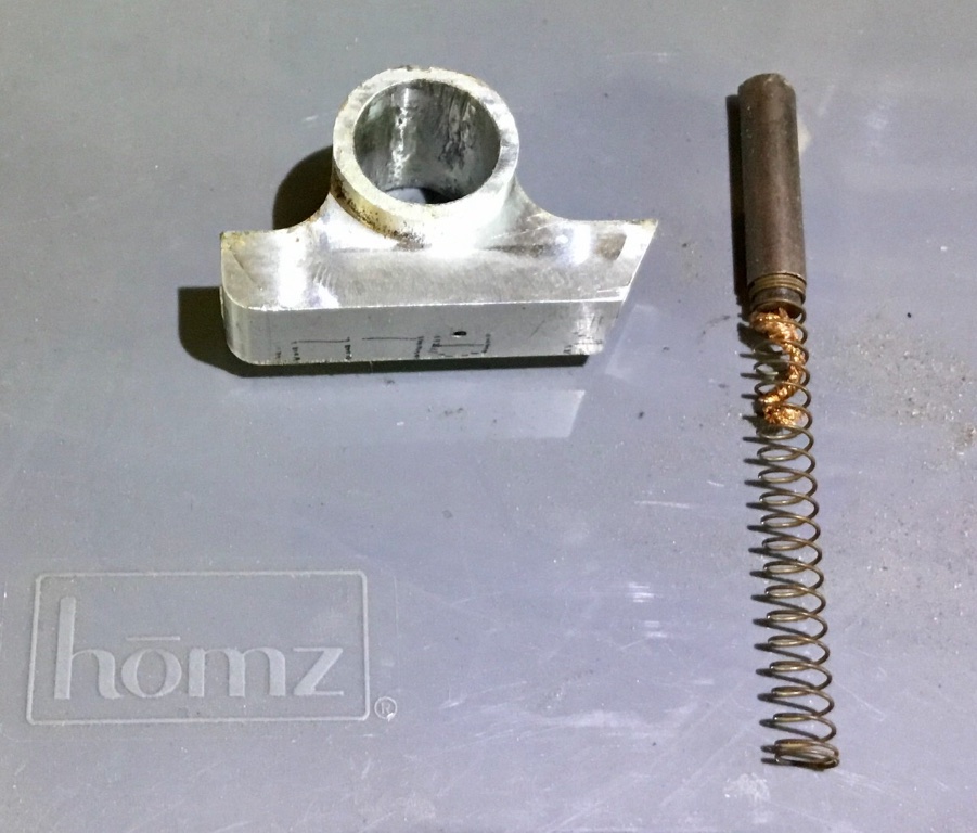

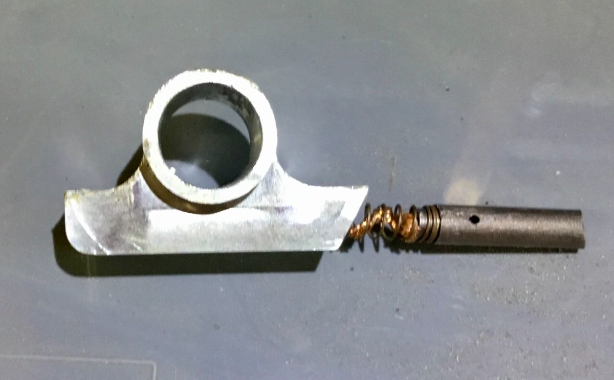

Posted: Sun Feb 20, 2022 2:37 pm
by jiminbartow
Sorry Tim. There seems to be no way to send pictures in a private email message from the forum, so I will Include them here. Best Regards. Jim Patrick
