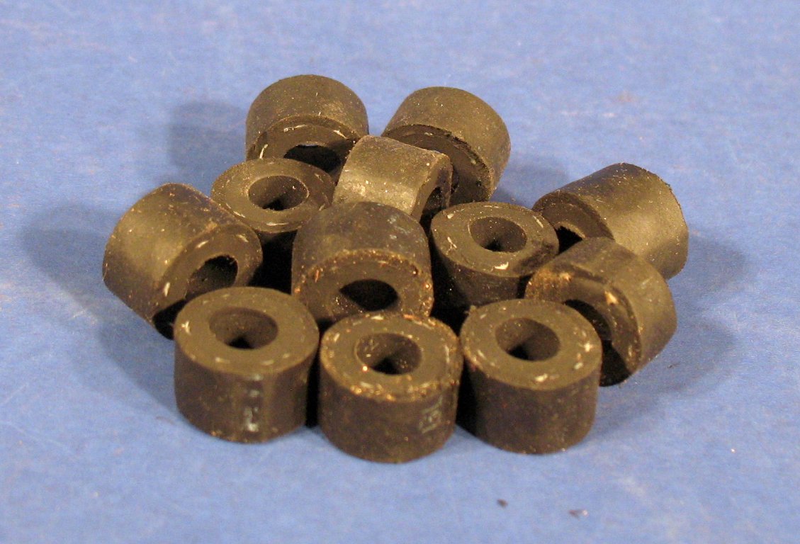

Throw the felt in the trash can and use a piece of neoprene gas line instead of the felt.
Re: I Was Surprised To See This
Posted: Mon Feb 21, 2022 12:04 am
by Steve Jelf
...use a piece of neoprene gas line...
