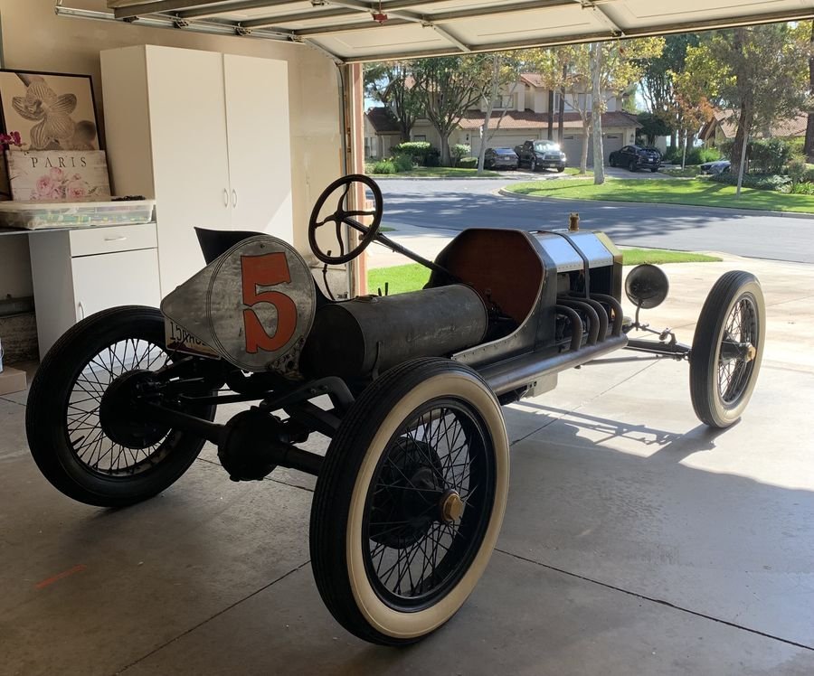

Is anyone using this 12v starter? How do you like it? I'm assuming you just cap off the bendix hole?

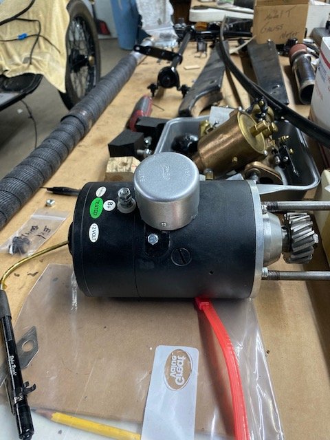

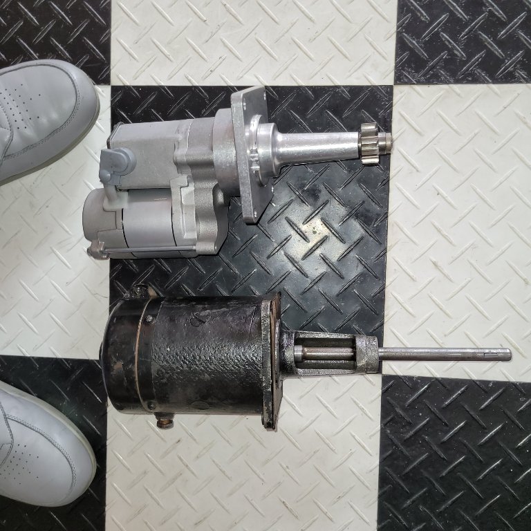

Thanks all for the replys. can anyone attach a photo of the "new" starter as it is installed? I really like the idea of this starter, but as issue I may have is this car (a 1915 Speedster) has a Franklin steering box and the clearance between it and the stock starter in minimal. The "Snyder" starter appears to be off set from the mounting plate, moving the starter itself closer to the engine. If this is actually true, it might work with the Franklin box?
Rod
Rod

This is one that was hot wired for a quick test and worked fine.

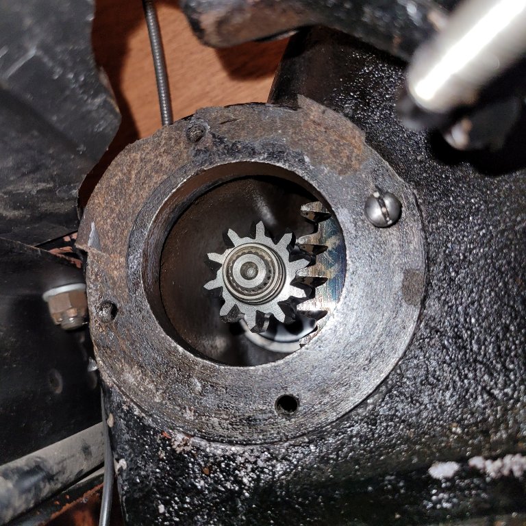

it also can be inverter to get more clearance

How does that work? Does the gear move out?

Dose the gear on the starter gear stay engaged all the time?

"Does the gear on the starter gear stay engaged all the time?"
No - that is one of the misconceptions about these starters. The starter gear is specially cut to allow it to easily engage the ring gear. It's a two-stap process, first the gear engages, then the starter rotates, releasing the gear when the starter switch/button is released. Being geared, it turns the engine over quickly, allowing me to easily start on mag.
The starter motor has been around a long time. To use on a Model T the distinctive nose had to be designed. Here is a link to the folks in England responsible for the design. <https://www.modeltford.co.uk/>

Here's a little background on why I am considering this. First the application will be on a heavily modified engine in a speedster, so no violation of the "purist" laws of nature. I.E. If I was to remove all the existing modifications to this car there would be but three nuts and 2 cotter pins remaining.
I got to this point after blowing out the Bendix while attempting to start it, it not only sheared off the bolt tip, it literally broke off the key so cleanly I couldn't find the slot in the starter shaft.

I received the Modern starter this afternoon, it fits but is tight up against the block. I understand that it can be rotated 360 degrees on its axis, but how? It didn't come with any instructions and what is on Snyders site doesn't cover rotation!
anyone have the proceedure?
Rod
Rod

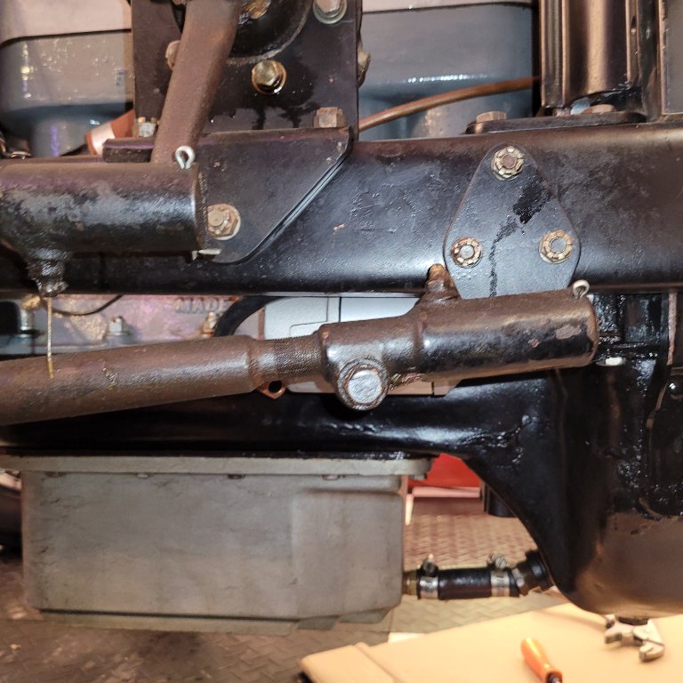

OK, forget the last questiob!Loftbed wrote: ↑Thu Feb 03, 2022 7:29 pmI received the Modern starter this afternoon, it fits but is tight up against the block. I understand that it can be rotated 360 degrees on its axis, but how? It didn't come with any instructions and what is on Snyders site doesn't cover rotation!![]()
Rod
I tried rotating the whole unit 180 degrees now it is upside down with the motor on the bottom (photos to come) it will bolt up in this configuration and the only issue i see would be it getting wet from water splashing up on it, but I don't drive in the rain so....
It is a real nice fit like this, nothing touching anywhere except the bolt up point.

Is there room to install the engine splash pans (-as originally equipped??Loftbed wrote: ↑Thu Feb 03, 2022 7:47 pm....the only issue i see would be it getting wet from water splashing up on it, but I don't drive in the rain so....Loftbed wrote: ↑Thu Feb 03, 2022 7:29 pmI received the Modern starter this afternoon, it fits but is tight up against the block. I understand that it can be rotated 360 degrees on its axis, but how? It didn't come with any instructions and what is on Snyders site doesn't cover rotation!![]()
Rod

Here is a photo comparison of old and new as well as some installed photos, I've still got to wire it up. above I stated that I rotated it 180 degrees, actually on 90 degrees.
Rod

Rod, your phot appears to show what I always suspected, that small gear is always in contact with the ring gear and the connection happens inside the starter case.
- Posts: 4504
Re: Snyders modern 12v starter
No, it's not in constant mesh with the ring gear. How could that possibly work? Read the posts above...
- Posts: 8709
If that's the case, that poor little gear is going to be revving about 20,000 RPM when the car is going 30 MPH.

Sorry But it is not in contact with the ring gear, the photo is misleading. I could actually reach in an move the gear on the starter.
Rod

Also if you look real close, you will see one of the ring gear teeth is overlapping one of the starter teeth.

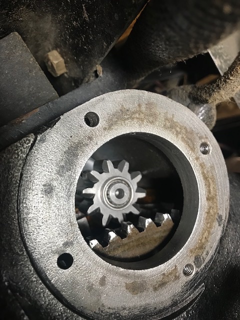

Please try not to be rude. We are all in this together. Here is a better view.

What makes the gear move in and out of mesh with the flywheel when the starter is used?
Bryant
- Posts: 1237
- First Name: Bryant
- Last Name: Shafer
I would assume that it is like any modern starter. It just has a longer “snout”
