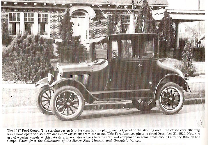

The route of pinstriping on all 1926-‘27 improved Model T’s are very simple. Start on one side at the back bottom of the front column and move forward, following the bottom curvature of the column, continue up the column, just below the center hinge, double back and continue across below the belt all the way around the car and back down the column on the other side. Pictures of my ‘26 coupe and my ‘26 Fordor show the same route. Jim Patrick

There were several stripe styles used on 26-27 closed cars. Jim did the one I think looks best, down the pillar and then follow along the bottom of the pillar. Another style the stripe goes down the pillar and stops. Another has the stripe go to the pillar and continue across the front under the windshield (my least favorite). And then there is the stripe that ends at the front of the door, neither going down the pillar or under the windshield, dead simple, but a little unfinished. Stripes on 26-27 closed cars really make all the difference for a paint job. Nice job Jim, well done. Dont know how you got those wheels and spokes all the same.

If I remember correctly, I think all Ford supplied factory photos show the 26-27 closed cars with pin striping. This would indicate the striping was done at the factory; not at a dealership. Also, the late Bruce McCalley's book, "From Here To Obscurity" shows two cars, claimed to be unrestored originals, a tudor and a coupe. Neither one has a vertical pin strip on the pillar in front of the door; only a horizontal pin strip on, or just below the body molding. In Bruce's later book, "Model T Ford, The Car That Changed The World", he has a section detailing striping. He states "The bodies of closed cars were striped at the factory. The strip was quite thin and appeared just below the body molding. On SOME of the cars another stripe was added on the front body pillar, this strip beginning at the front edge of the upper body strip and following the curve of the pillar down to the bottom near the splash apron." I have a photo of my Mom in her brand new 27 Fawn Gray coupe and it shows the stripe in a partial view. When I find where the scanned picture is stored in my computer files, I'll post it.

Here is a period photo from December, 1926, of a coupe with original pinstriping. This is the photo that taught me the way it was done by Ford. Jim Patrick
