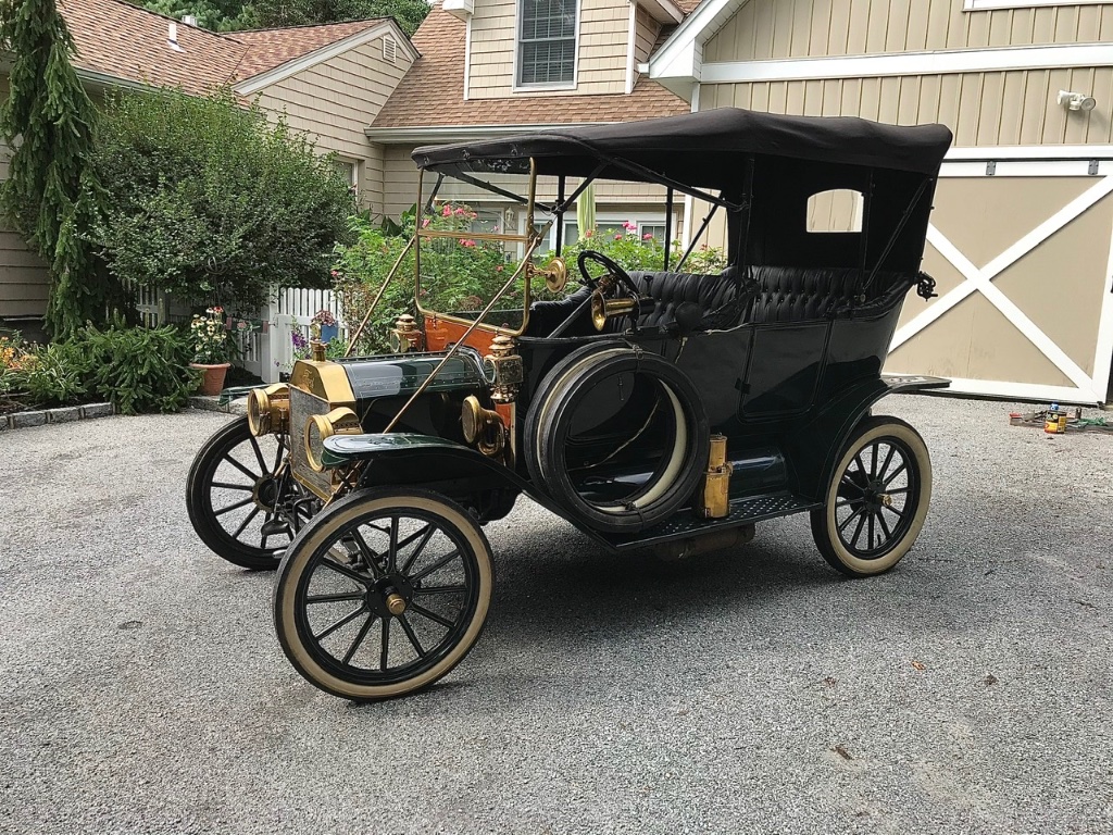

Top 'O the mornin' to ya!
Perhaps a few of us can post pictures of our '12's to give you some ideas as to how you may want to finish your car.
Mine is done up as a good driver and not a show car. The color on my '12 is probably wrong for a touring, the tires should be smooth white ones and I put brass step plates on the running boards! Other than that it's pretty original. Leprechaun optional. :lol:
I believe my Canadian T is an April? build. The stamping isn't great on my dash plate but it matches my engine stamping. It reads 110338. Please note: my door handle should be vertical when locked. I had an August 1912 T touring and it didn't have outside door handles on the back.

Mine is original except for the prestolite bottle. Wrong color of course and whitewall tires but I like the look!

Mine is a later style with inside door handles. They made lots of body style changes during 1912 and mine is the last one. Slab side with inside door handles. I will get the motor number and approximate build date for you tomorrow when I can get over to the car.
