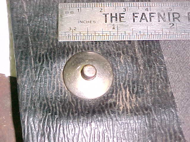

The sockets for side curtain fasteners used on the '26-27. Mounted to body holes and to top iron holes to receive the pushbutton fasteners.
Sockets ( p/n A24562 Female) were covered openings with spring 'door'. The fasteners (p/n A24566 Male) have pushbutton 'grippers' that hang inside the rim of the sockets.

I want to thank Mike at Classtique for reminding me that the sockets on the inside of my top irons are to secure the rear edge of the top, and Dan for the wonderful pictures. I have never seen the male portion and it's easy to see how it works.
