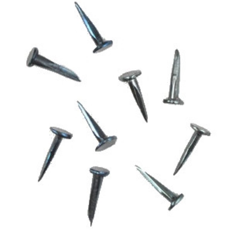

Just looking to see if anyone might know/remember what size they used when re-installing the kick panels, Not the upholstery nails that hold on the welting, rather the tacks that attach the kick panels to the wood frame. The kick panel material is 3/32" in thickness, so I am thinking that the 2.5 oz tack would be the right size. Any help is greatly appreciated.
2.5 oz is 5/16" in length
3 oz is 3/8" in length
4 oz is 7/16" in length

I would use the 3 oz tacks an the bare minimum. The wood is old and could possibly be a little 'punky'. The longer tack will probably hold better. Just my opinion.

Arcane, yes. The thickness of leather is measured in ounces and the size of the tack would indicate the thickness of leather it would securely clinch, a 3oz tack for 3oz thick leather.

The tack holds the panel to the wood frame:
Once the panel is in place, the upholstery nail holds the welting to the panel and frame:
