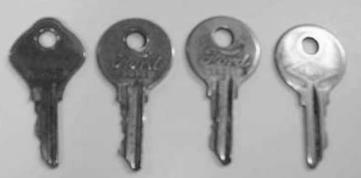

Posted: Sun Apr 03, 2022 10:25 pm
by lirogo27
Guys- picture FYI ONLY

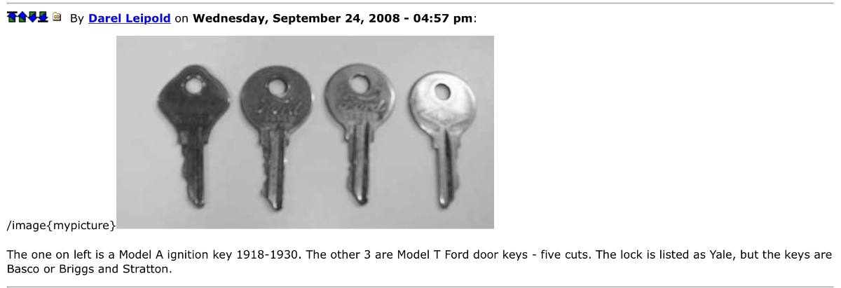

No joke. basco. Briggs & straton. The blank looks like a "B1" key blank. I have one for a locking gas cap. There are several "B" blanks on their boards. B3 is another popular one. If the cylinder can be removed & freed up, its a simple operation to disassemble the cyl (typically)& file a key. Use the ACE key blank. Last step in the restoration is to find a NOS properly marked blank & duplicate cut from your working ACE key. Or find an original cut key & change the cylinder pins or equivalent parts.

Here is a picture of the 2 keys for the 24 Coupe door lock on my car. It’s a picture showing both sides of the same key. Look closely at the pic that dropacent sent and you can see it has the same key way as the originals he shows. Mine probably has different cuts but it’s the same key as his originals.
This key is a Ilco 109SX. Or it could be 1098X. The stamping might not be clear. Most lock shops should have these. I got mine from Ace hardware about 10 years ago. If not they are probably available online and other brands probably make the same type of key.
It’s a fairly common key for different types of locks.
